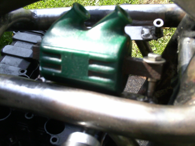

This is my current mounting setup. They’re longer spacers than stock.

04 May 2025 10:32Looks like you are using the mount furthest away from the terminals too so shouldn't have issues with shorting.This is my current mounting setup. They’re longer spacers than stock.

I’ll get another pair of Dyna coils ordered up. I’ll try the plastic spacers and water-proofing the terminals. Thanks for all the help, guys.
