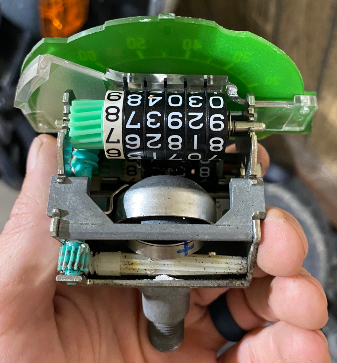

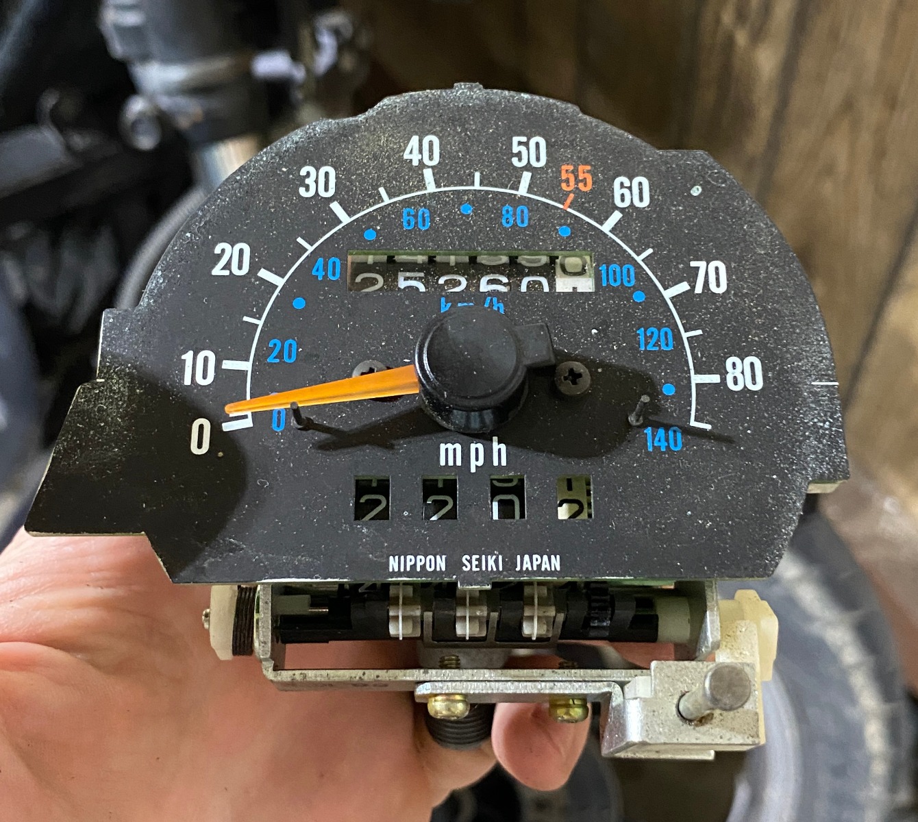

Mine is easy. 3 screws to separate the housing halves, and 2 holding back of speedometer in.
Once removed, I put the square drive bit in the cable drive hole, and ran the drill as fast as it would go (full trigger).

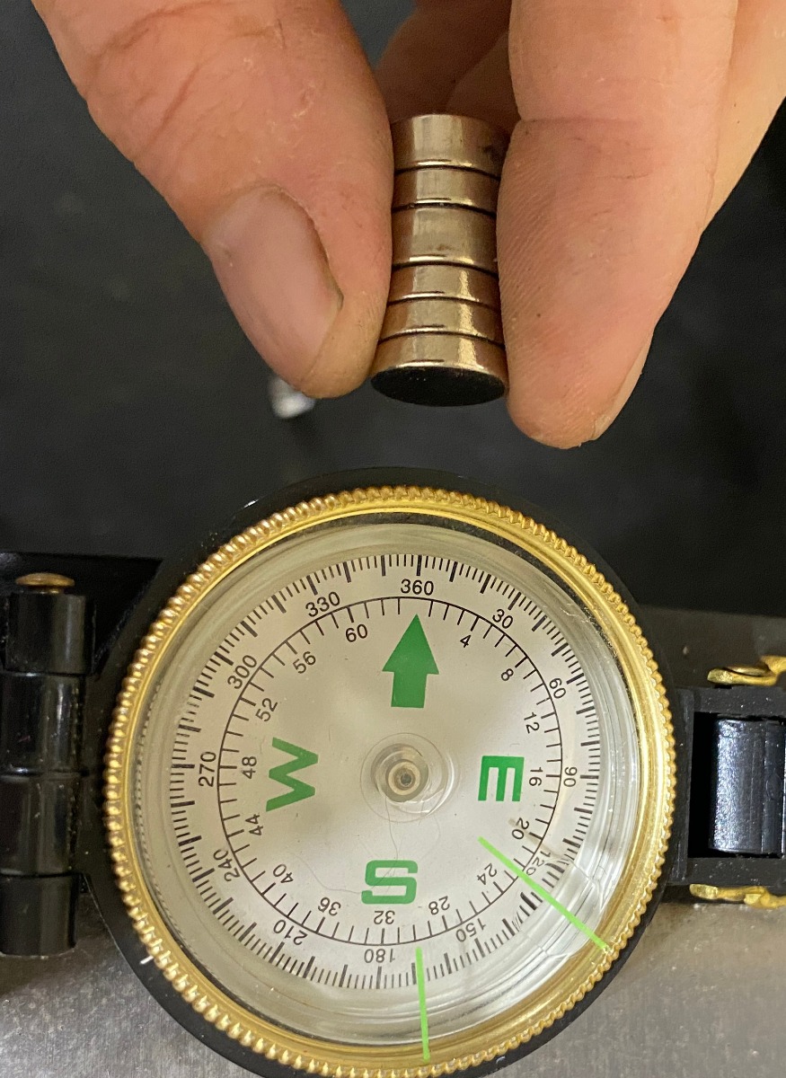

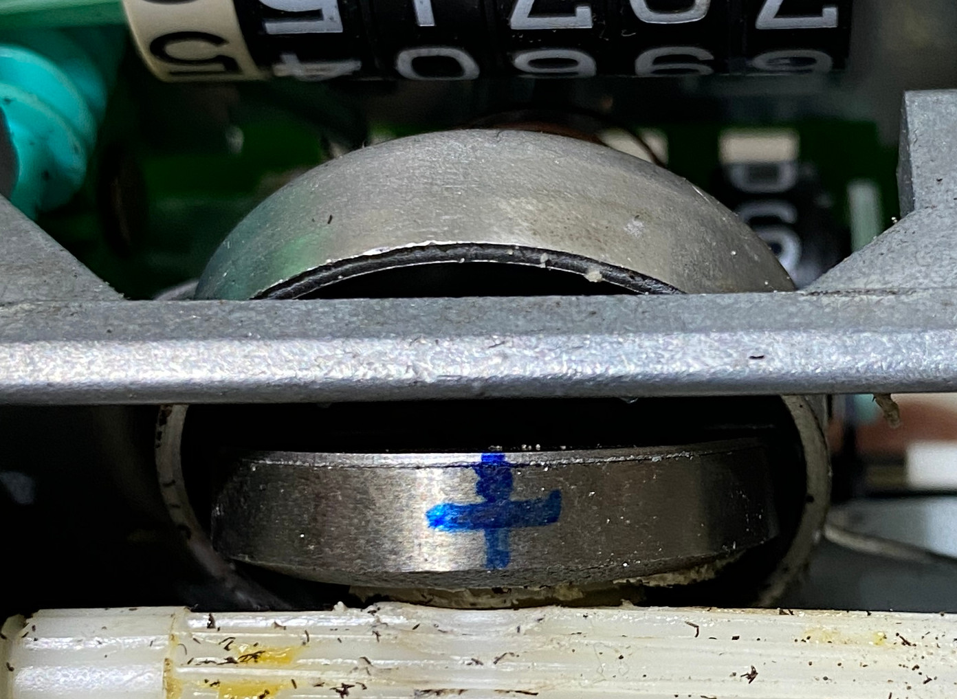

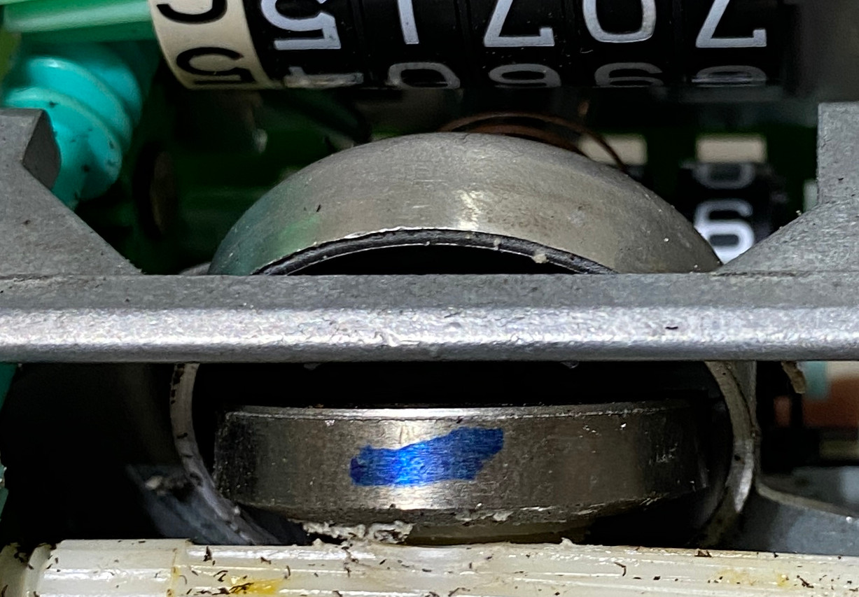

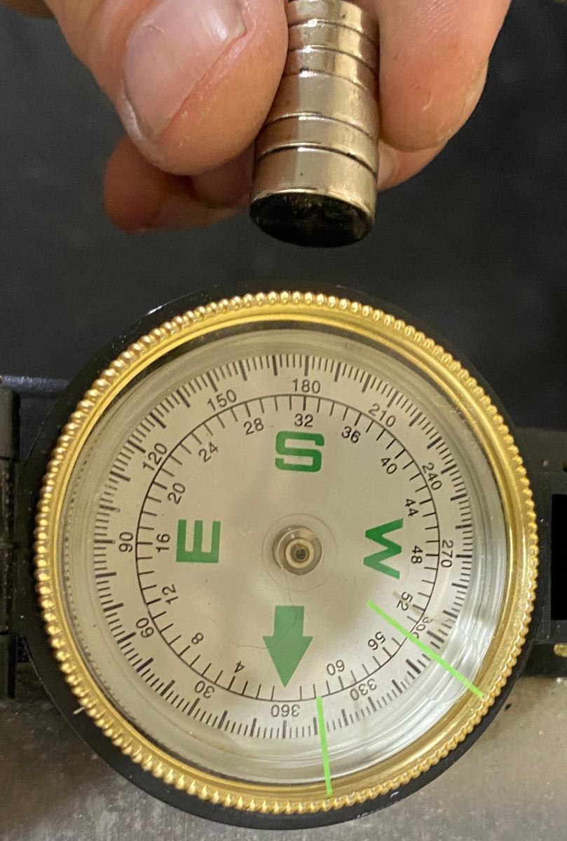

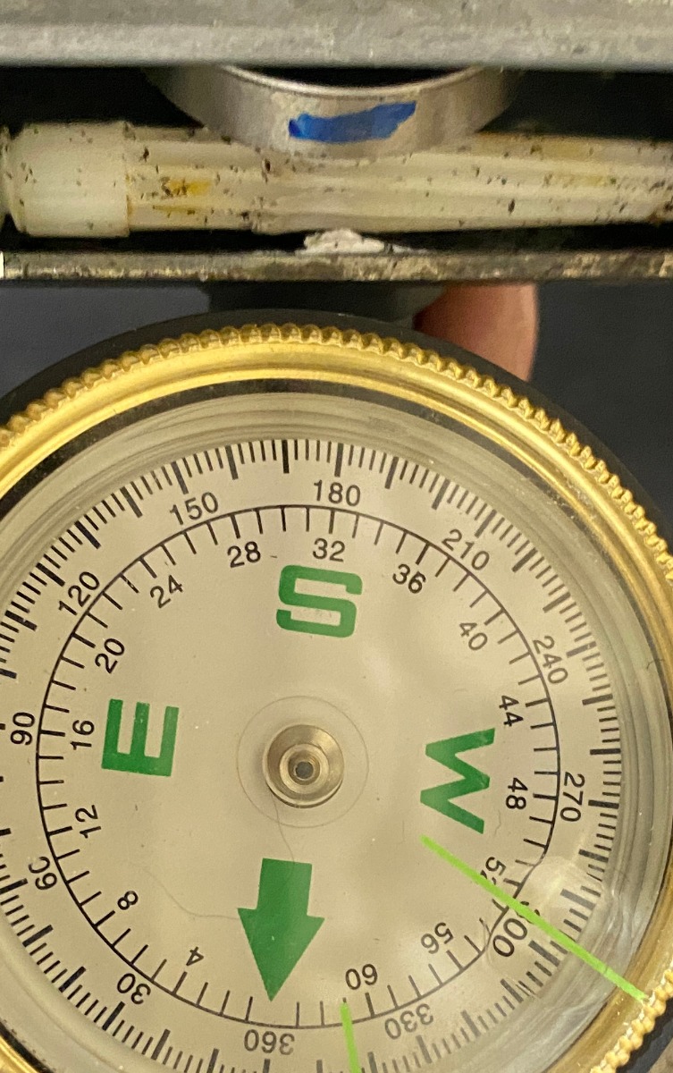

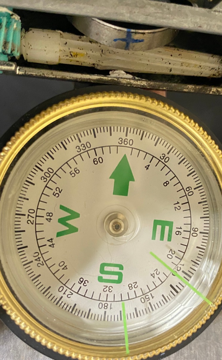

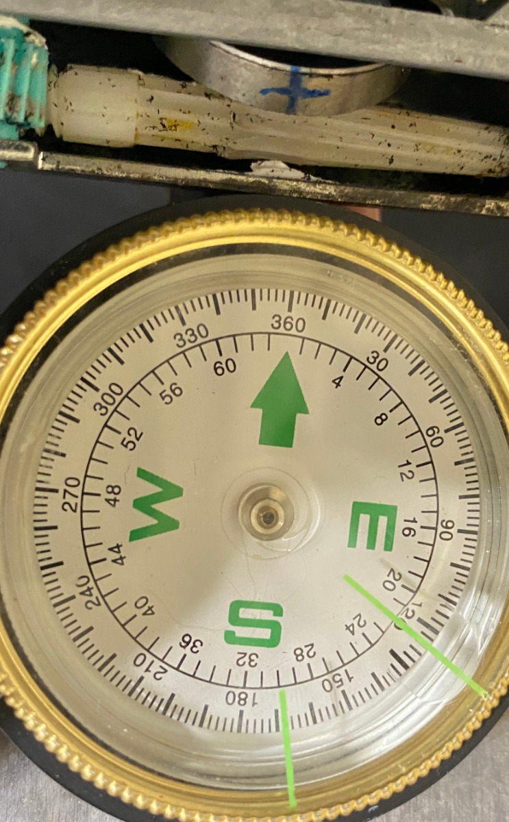

Next, I took my compass and held it to the magnet ring. I slowly rotated the ring to show the "poles", and their "polarity".
Mine had 4 poles. 2 north, and 2 south. I marked each pole. A + for "north" and a - for "south".
I did the same, for the stack of magnets.

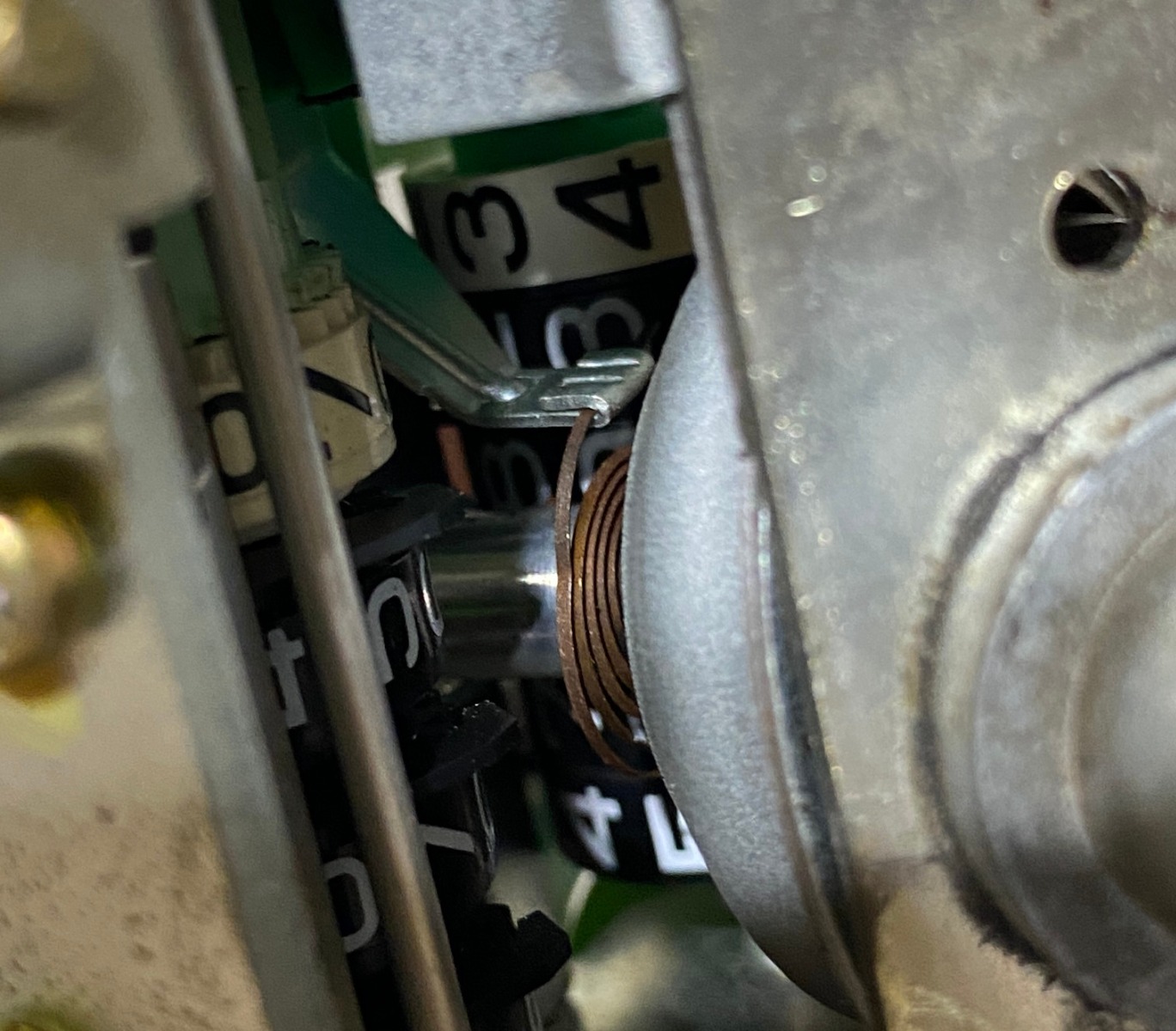

from research and trial/error, i would stay away from the spring. the spring and magnet ring work together. the faster the magnet ring spins, the more force its going to impart on the cup. but also, the further the cup rotates, the more back pressure from the spring. Adjusting the spring will change the ratio between the two. When the magnetism fades, it makes the spring "too strong", the further it rotates. If you try to reduce the spring pressure only, it will make the lower speeds read higher. If adjusted too light, the needle may not even reach zero.
clock spring:
the further it's "wound", the spring force progressively increases. this is controlled by the spring material, length, etc. Adjusting the spring only changes the "preload", in a sense. it will still progressively increase as the shaft is turned, but at a different point range.

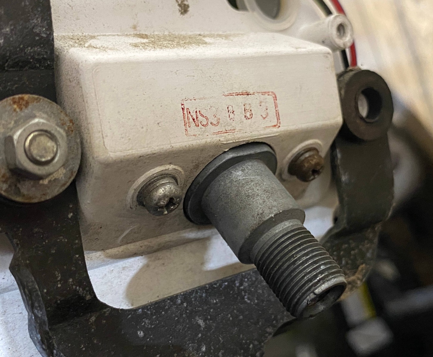

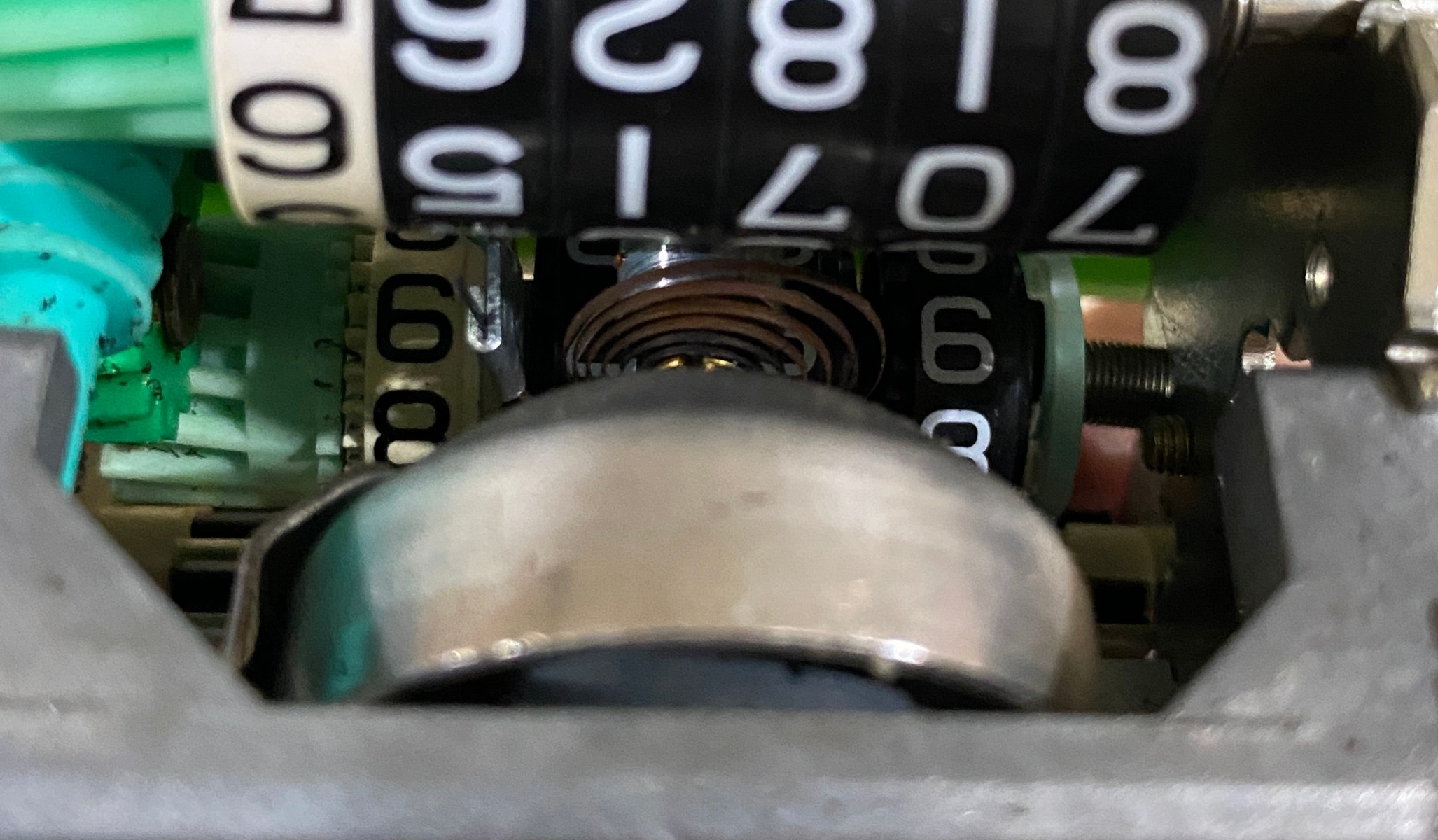

ok, pictures to go with the write up:
two screws holding speedo into housing
Speedo removed from housing
aluminum cup over magnetic ring
close up of clockspring on spindle
N pole marked on magnetic ring
S pole marked on magnetic ring
Finding the poles of the ring and the magnets
Some trial and error may be needed depending on the size, strength, shape, and pole orientation of the magnets you might use.
I did not picture how exactly i held the magnets, as i don't want to mess with what is working.
UPDATE: The speedo is still holding accurate. So the "fix" seems to be permanent, at least for another 40 years.
@TexasKZ pics added
