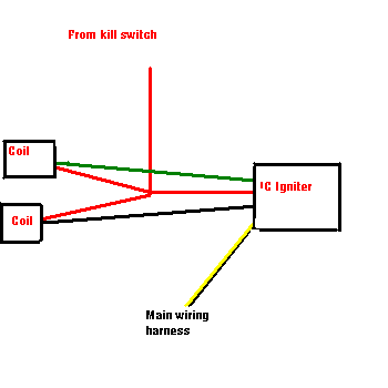

Wire colours are different for different bikes.
The coils each have two wires from them. Of the four coil wires two will be the same colour and go into a double bullet connector. Those two are the power to the coils.
The other two will be two different colours, likely green and black. These two are the pulse ignition wires from the ignition plate.
This is what you need to achieve.

What colour are the positive supply wires to the coils ( these are your trigger - there should be a junction where the “ two become one”)

NO, Yellow is the 12 V ignition input to the Kill switch, you have to connect to the (kill) switched 12 V ignition output = yellow/red wire!!!

19 Apr 2025 11:37Left coil is red and green and right is red and black. I already made the new red wires which come off the relay. I only need to hook up the trigger which is what I can’t find.What colour are the positive supply wires to the coils ( these are your trigger - there should be a junction where the “ two become one”)

19 Apr 2025 11:41Disconnect the two red wires from the coils, follow them back until they join to a single red wire from the kill switch - this is then your trigger wireLeft coil is red and green and right is red and black. I already made the new red wires which come off the relay. I only need to hook up the trigger which is what I can’t find.What colour are the positive supply wires to the coils ( these are your trigger - there should be a junction where the “ two become one”)

19 Apr 2025 13:54No problem - insulate one of the reds from the coils and use the other as your triggerAnd that's the issue. The wires disappear into the heavily taped factory wire loom. I would need to start slicing the tape around the wire loom and that makes me extremely nervous considering the age.Disconnect the two red wires from the coils, follow them back until they join to a single red wire from the kill switch - this is then your trigger wireLeft coil is red and green and right is red and black. I already made the new red wires which come off the relay. I only need to hook up the trigger which is what I can’t find.What colour are the positive supply wires to the coils ( these are your trigger - there should be a junction where the “ two become one”)![]()
