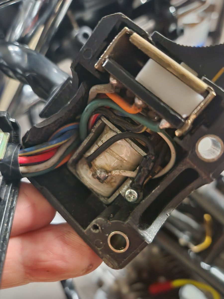

Can anyone tell me what the "transformer looking" thing in the left controls is? I have been searching for it all morning. Now that I have my ignition switch repaired I am only getting nine volts at the headlight plug with a full charge on my battery. So basically I have lost headlight and tail light. I am switching 7" over to a sealed beam headlight.

A picture would help, before you get hung up on the switch check the "input" voltage to the switch from the fuse-box (there are several places this volt drop could occur) there is a section in my diagnostic guide (link in my signature) ref pin-pointing resistive faults

I think you will find that is the solenoid for the self cancelling indicators

Thank you Wookie. I learn something new every day.
