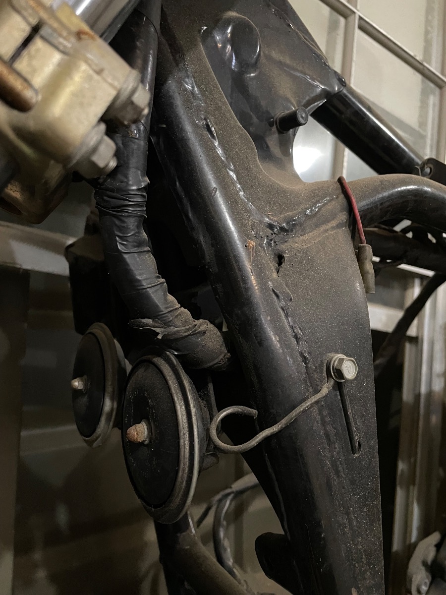

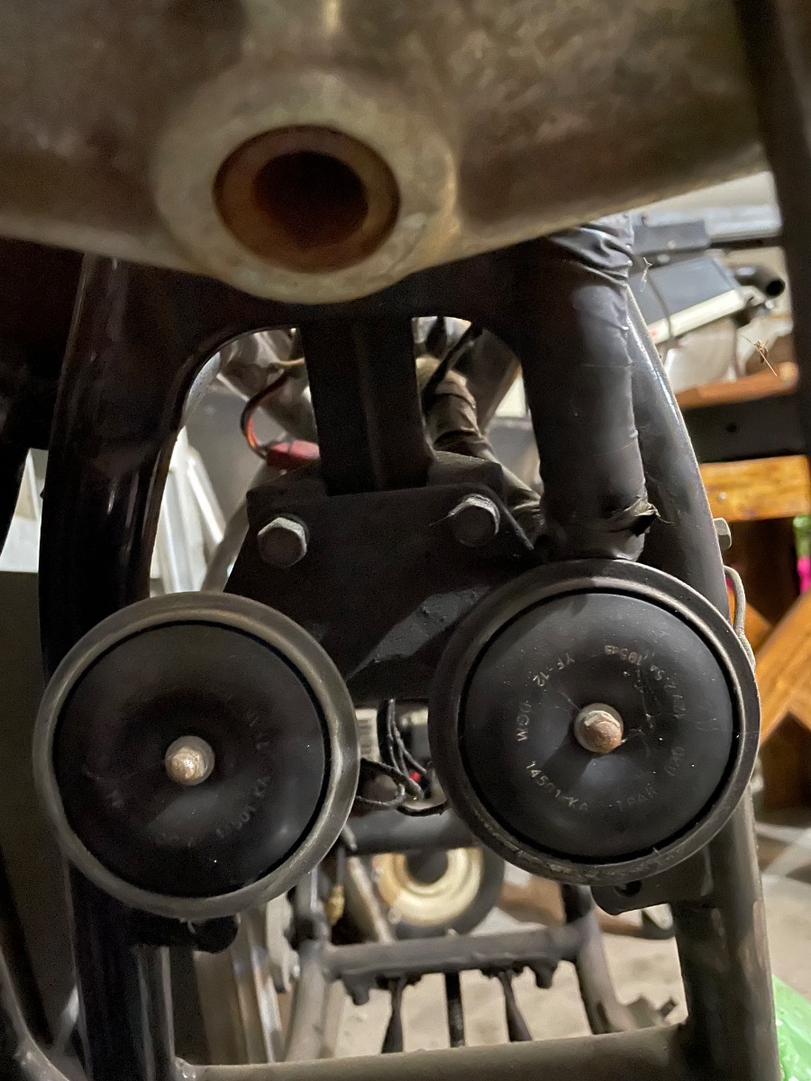

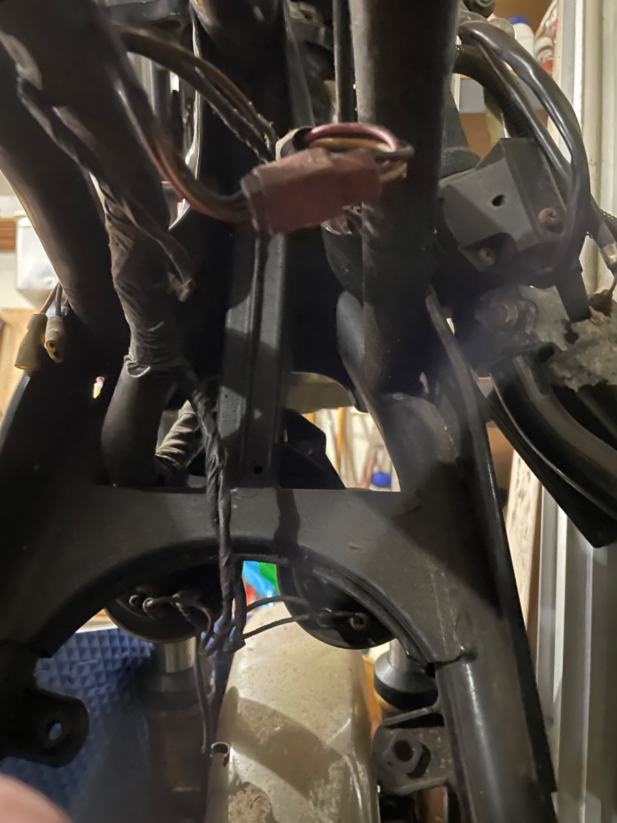

Here is how it goes on my parts bike. It is a 1982 LTD 1000.

Thanks everyone for the information, Especially TexasKZ!  As soon as I get done making the smog block off plates I will be able to get those wires back wher they belong.
