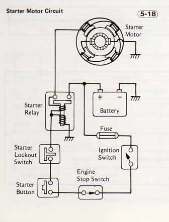

Not claiming I have the answer for you but your starter system should look something like this pic. There maybe more switches or connections but it will be much the same.
Your task is to figure out what is not working?

14 Jan 2025 11:51If you look at my fault finding guide (link in my signature) towards the end there is a generic flow chart for starter fault diagnosisIt simply no longer makes any sign of life, no sound of turn over, nothing.
