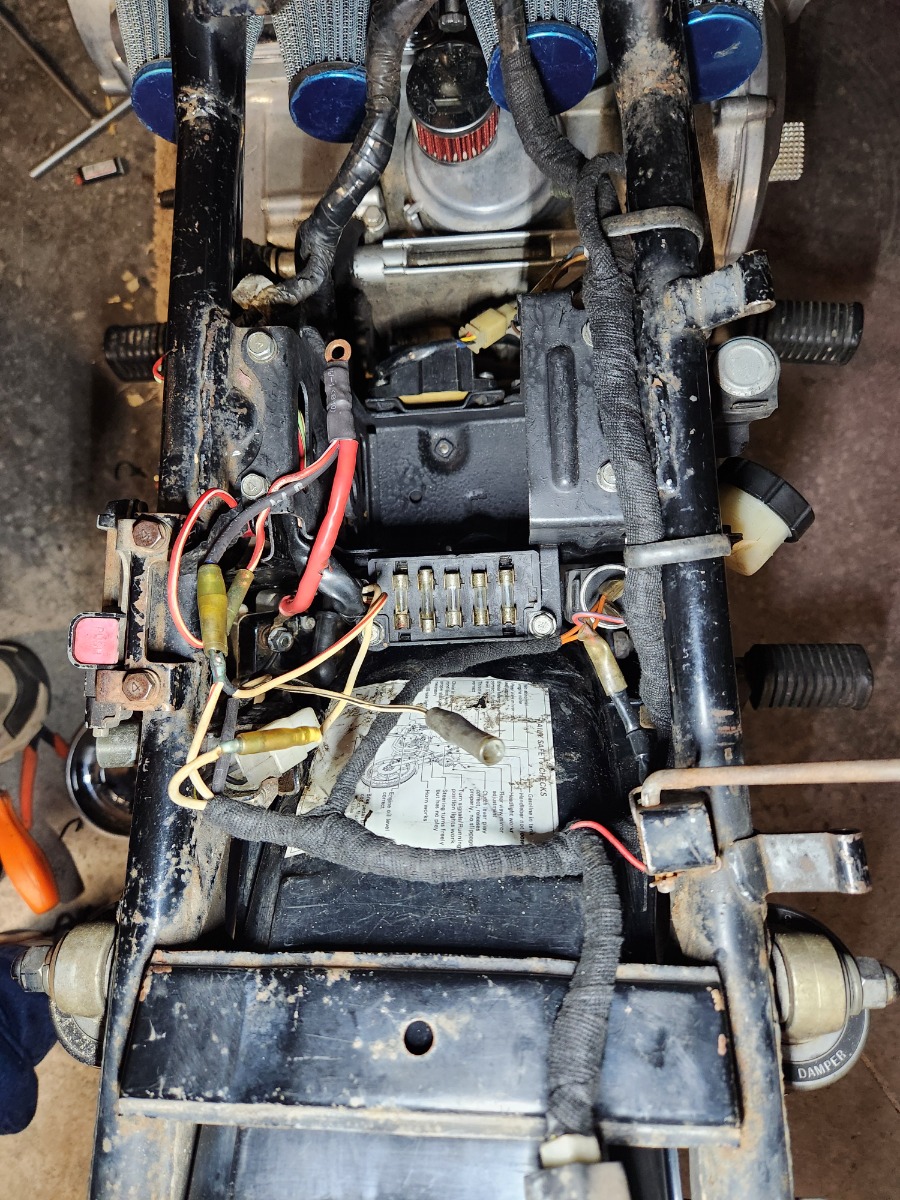

when I got the LTD, the wiring harness was hanging out of the bike. I have been trying to put it back where it belongs with pics from the internet. I am down to a few wires at the battery box. I have a white wire with a black trace and a female bullet connector left... My diagram says its a horn wire. Any guesses to what it is for?

accessory lead w 10A fuse. wire should go to a nearby acc fuse box assy. mounted to a small bracket. should be visible under the LH side cover. the other acc wire. blue/white. goes to the headlight bucket.
