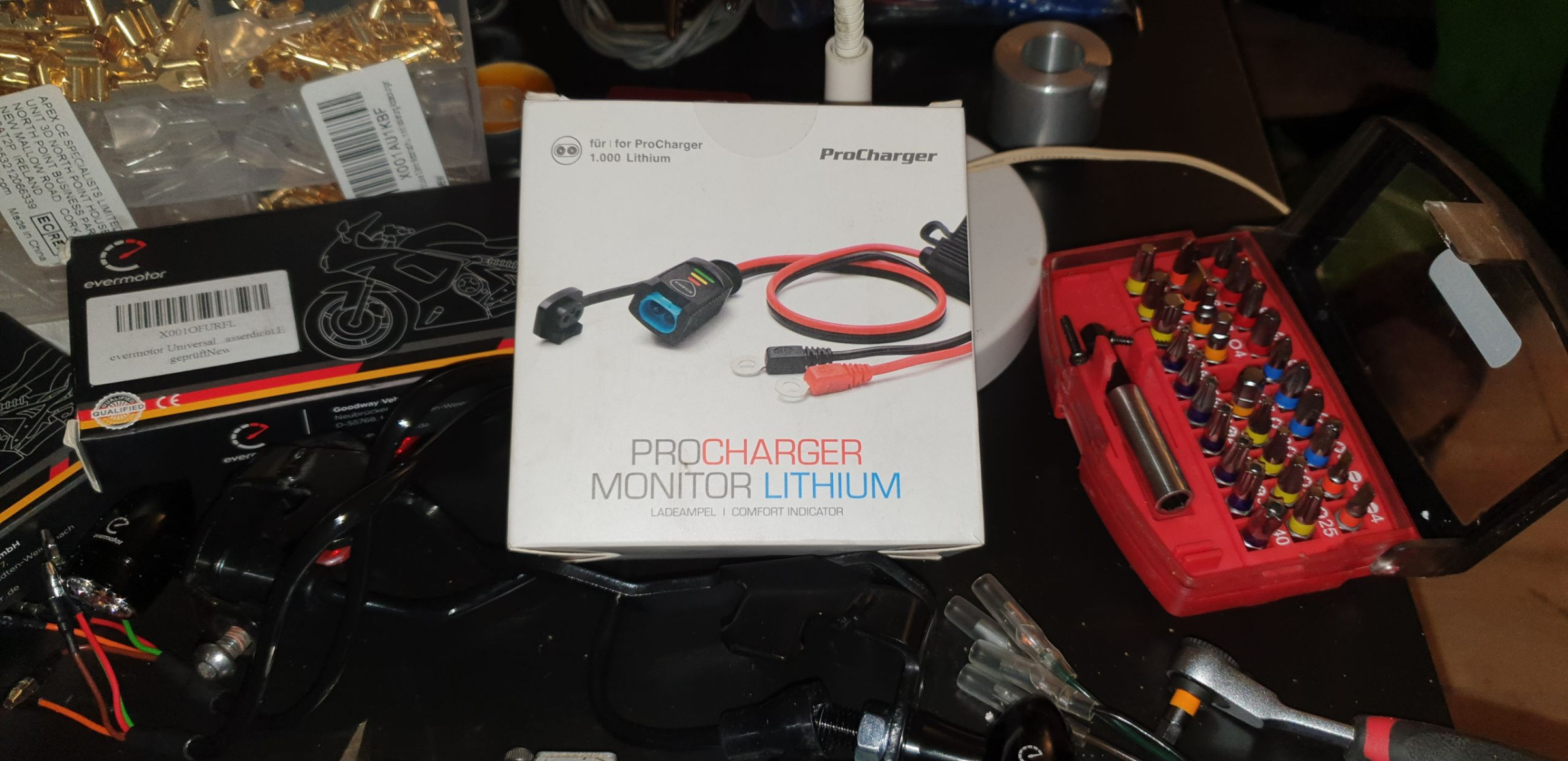

I´m using a battery voltage indicator (LiFePo) sold by Louis.de with a ProCharger 4000 battery charger.

So you don’t have notification bad charging when driving than?
