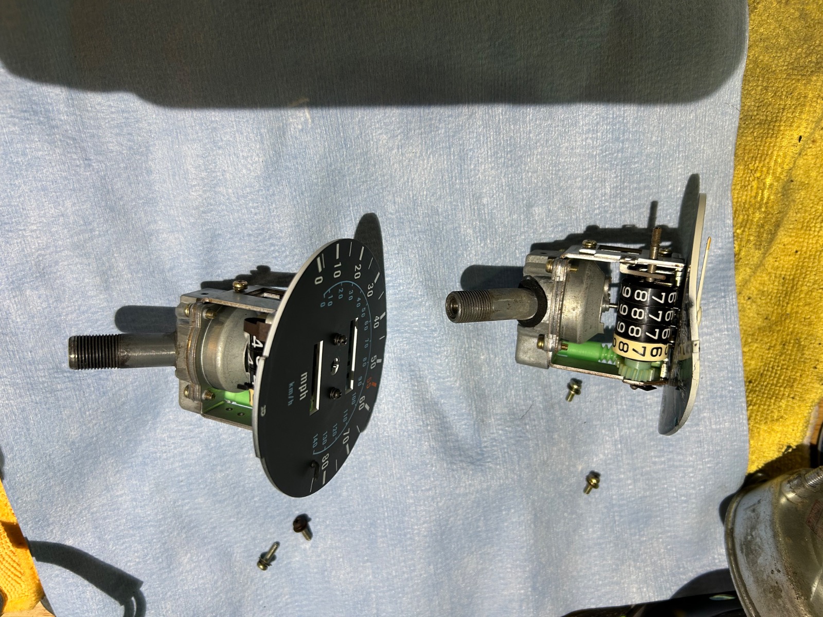

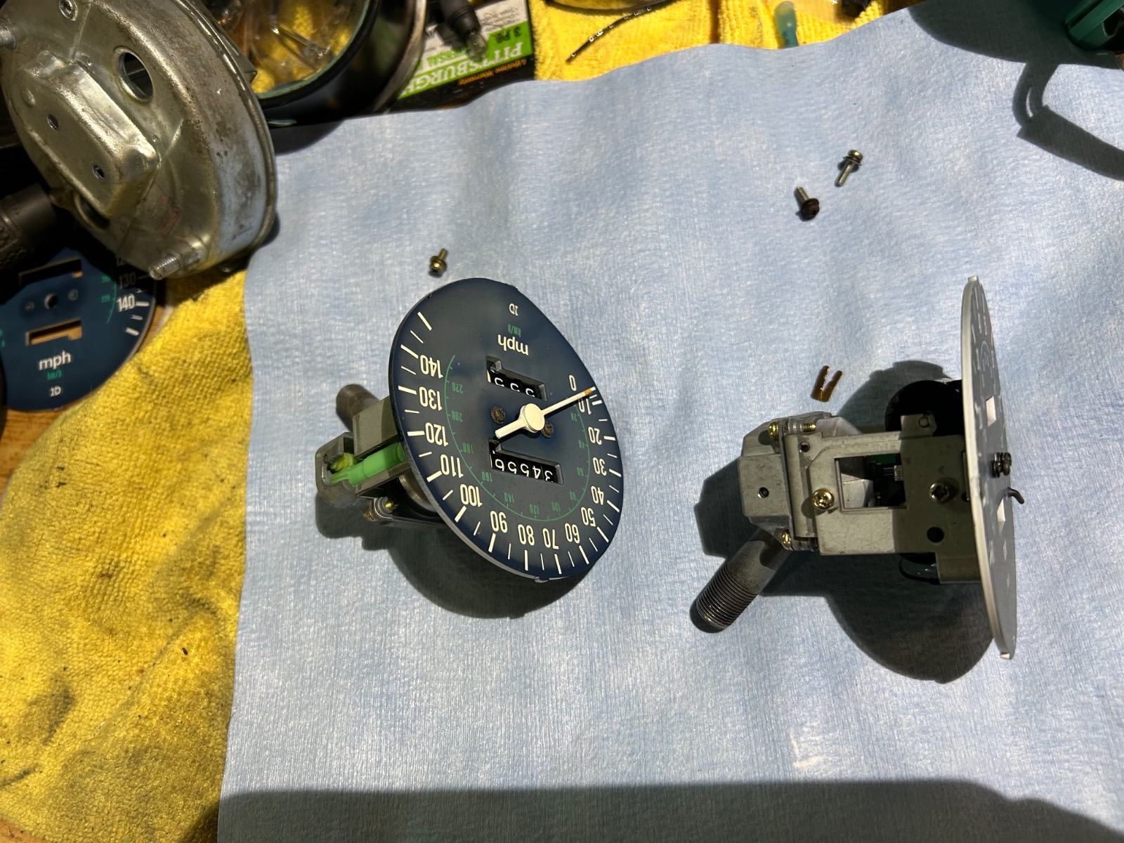

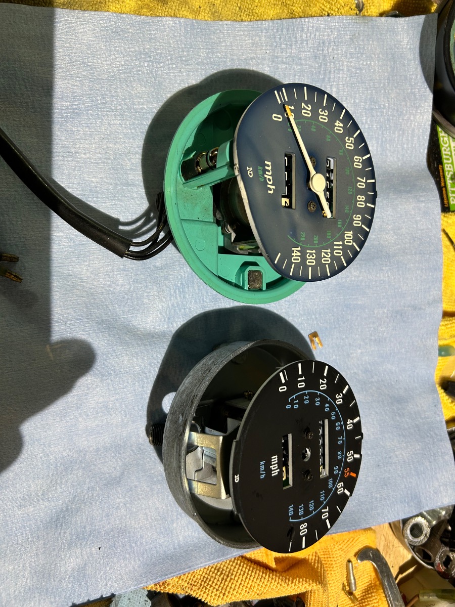

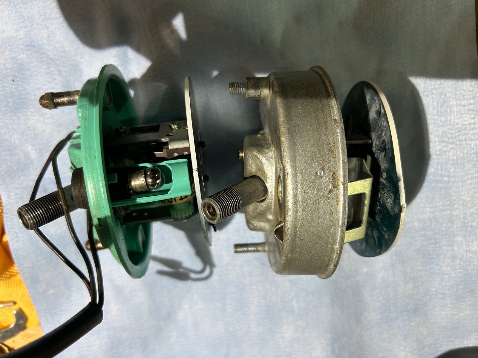

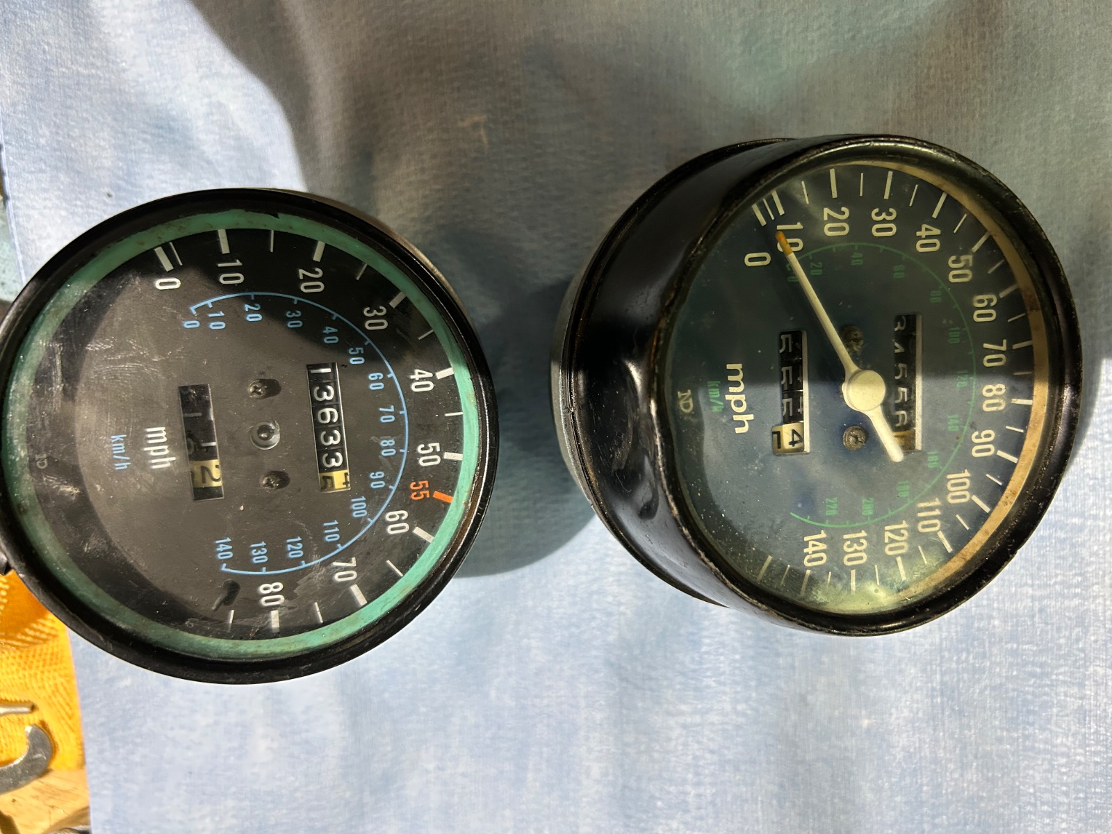

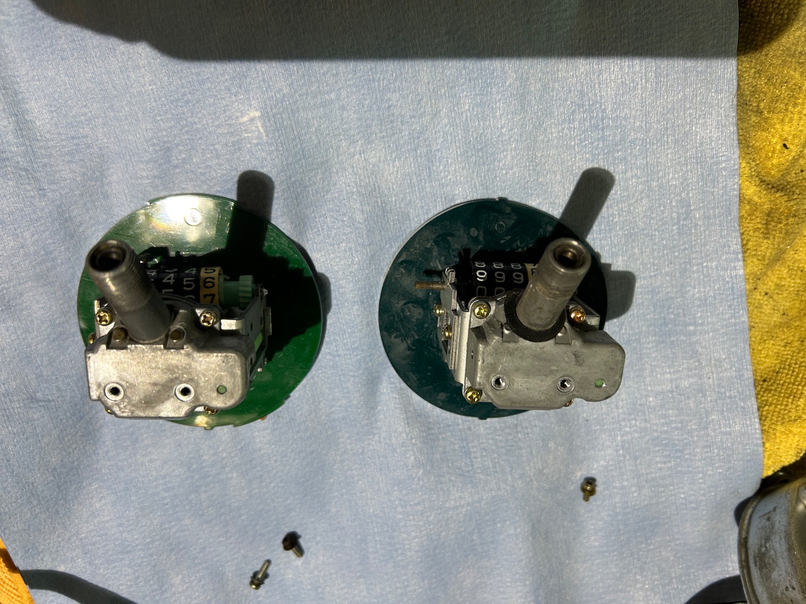

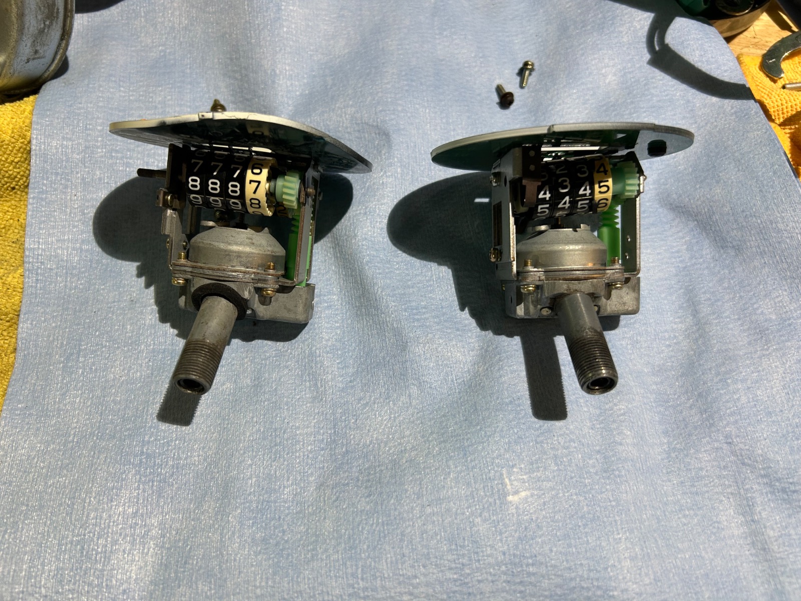

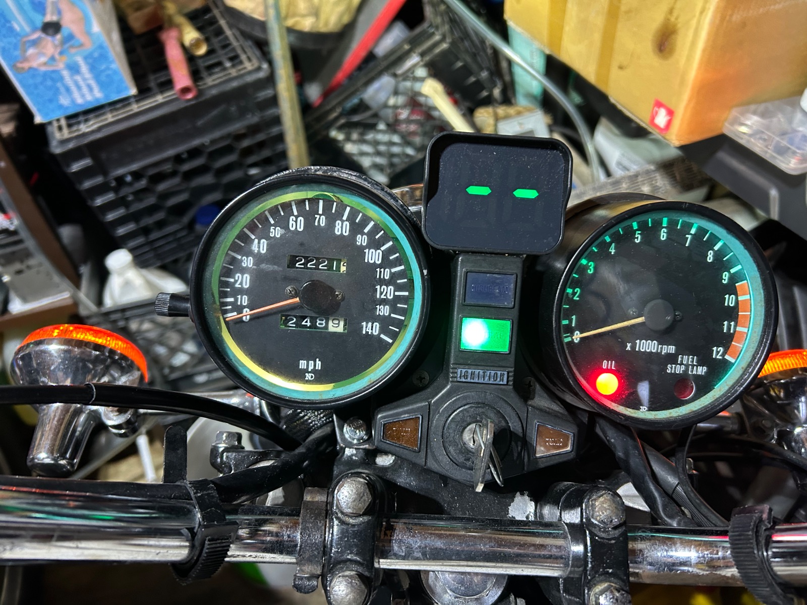

If you feel like taking the speedo apart, it can be changed, this is a ND unit, side shaft reset, late 70’s honda units from 650-750’s are also ND’s, with side shaft reset, hondas at this time were 140mph, internal units are the same, except for gear ratios, they can be swapped,pics below
blue dial is honda, I got a black dial from retro in WA. the honda reset shaft comes out, the kaw doesn’t but knob comes off, was just experimenting to see if this would work, and quite accurate, checked with gps speedo,(black box between speedo and tach)
or you can just swap out to gps speedo and electronic tach, they are all over ebay and amazon, will need to adapt brackets,
