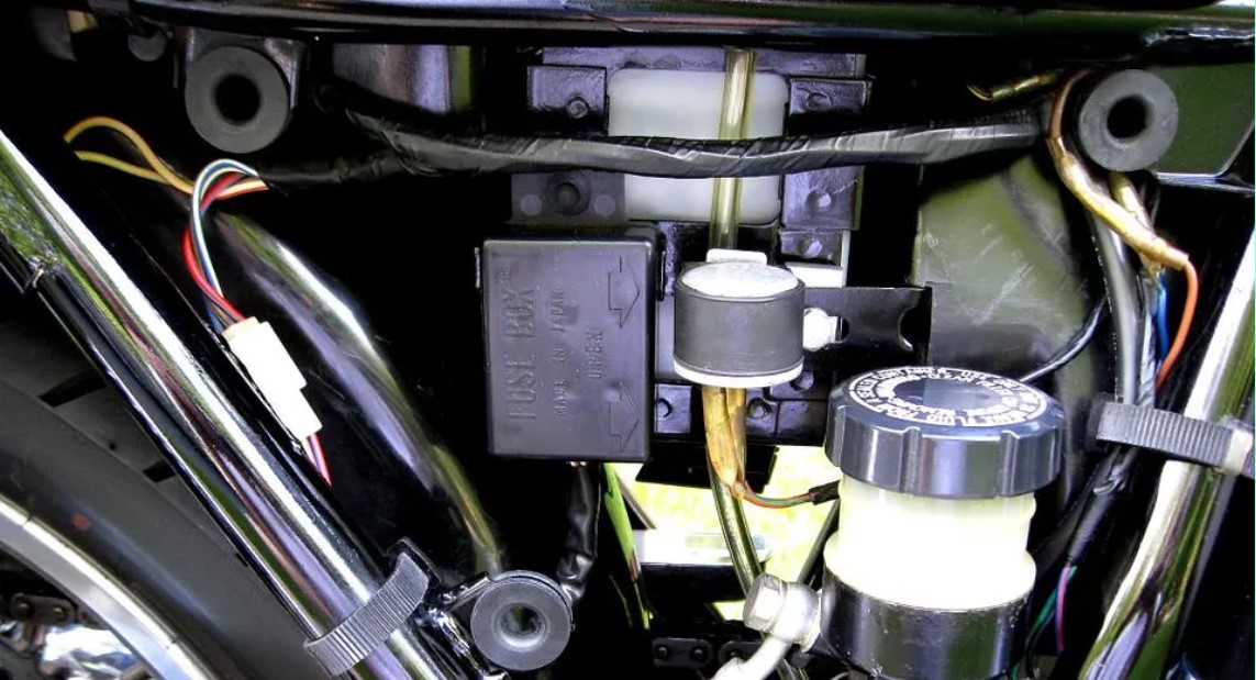

IM trying to identify what is missing on the right side of this KZ650 I'm working on. There is a round rubber holder but nothing there right beside the fuse holder box. I've attached a picture.

Flasher for the turn signals?

Some markets had hazard (4 way) indicators fitted.
The flasher unit for the hazzard lights is located as per your picture. The flasher unit for normal directional indicators is located on the main electrical board under the side panel on the other side.
If you have a hazards the switch will be on the lefthand handlebar controls.
Both flasher units are the same.

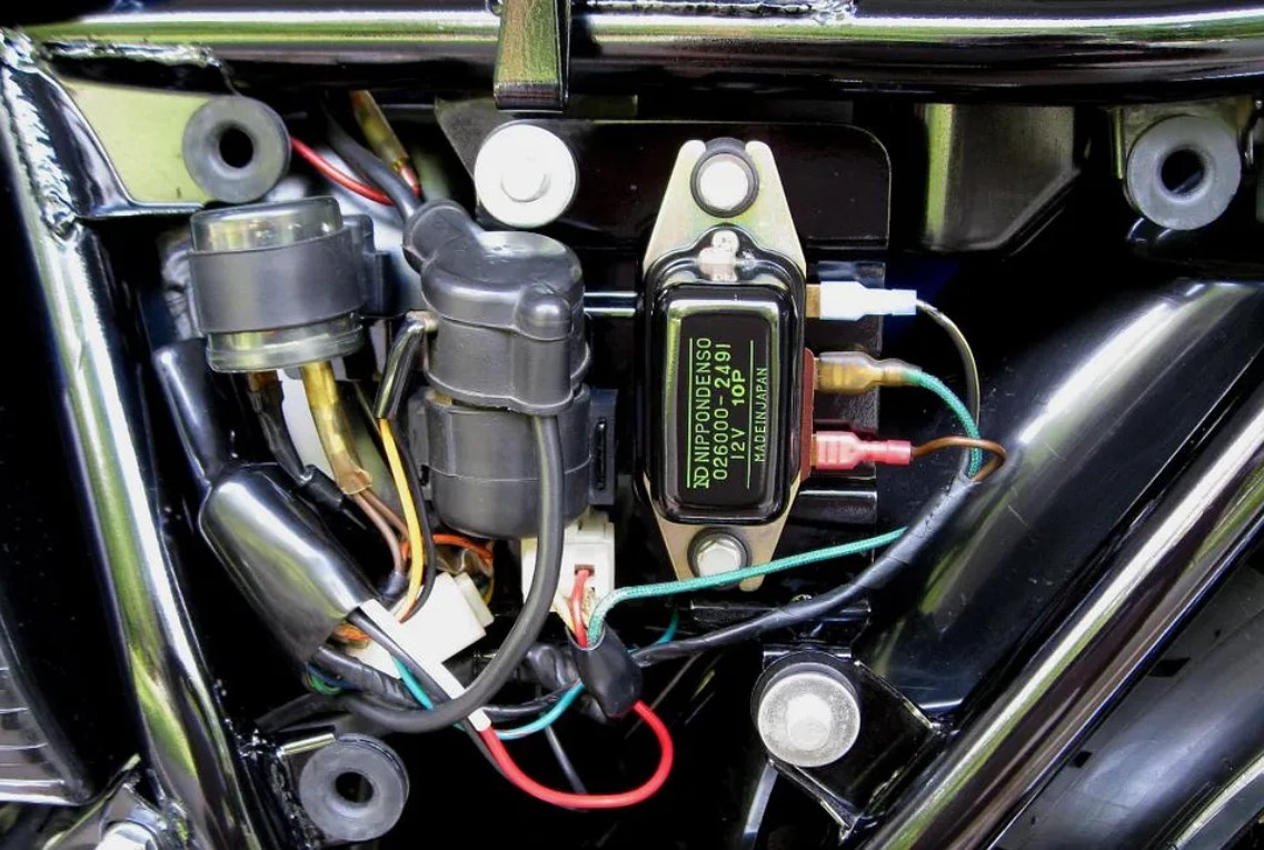

06 Dec 2024 12:54On my Canadian B2 there were two flasher units, one for turn signals and one for hazard lights. Both were under the LH side cover.I thought that too but there is one on the left side.
You have a disk brake on the back and if you say its a 77 then its a C1 model.
Here are some pics of C1 electrical under both side covers :
