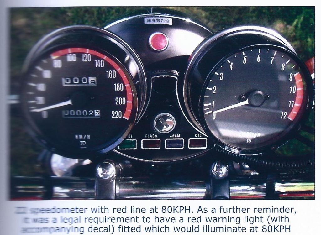

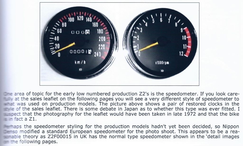

The following images are courtesy of the pre-press proof edition of John Brookes upcoming new edition Restorer's Handbook. Apologies for the blurring. The book is quite thick & doesn't fit the constraints of the scanner very well.
These are best-documented examples to date. If anyone has dated hard-copy examples that differ, please share & we'll forward to John for his evaluation & possible inclusion in the new edition.
There's some discussion in Japan of which speedos made it into production. We'll let the caption of the photo below speak for itself.
The Japanese sales handout appears to be the same type prototype speedo seen above. See top center next to the bike. Lighting isn't good, but the red increments are clearly there.
The documented production speedos have a 'red line' instead of the red characters & increments of the prototypes.
