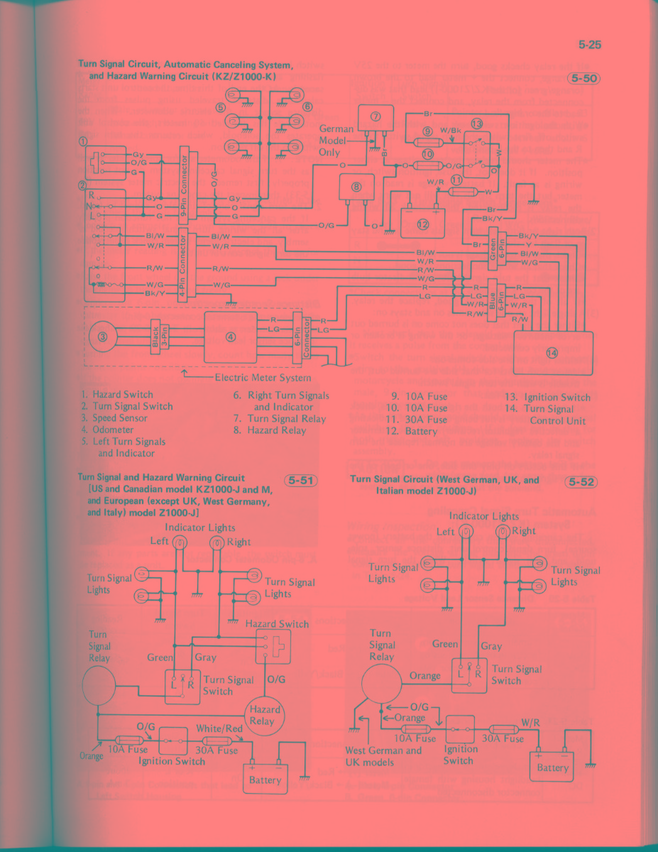

It could be a relay, or a switch or connection or ??? Do you have a wiring diagram for your machine? Have you taken a look at wookie's test info?
As to what it looks like look at the diagrams on partzilla
www.partzilla.com/catalog/kawasaki/motor...electrical-equipment
As to location I would look under side cover for starters.

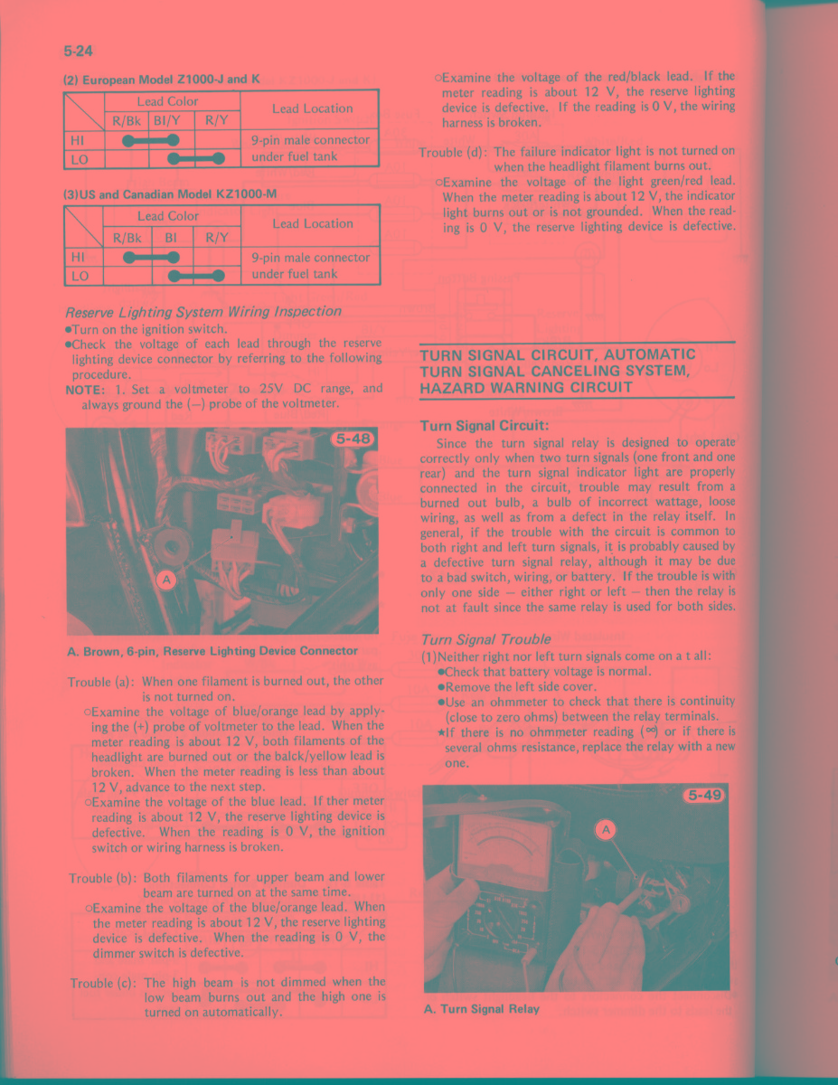

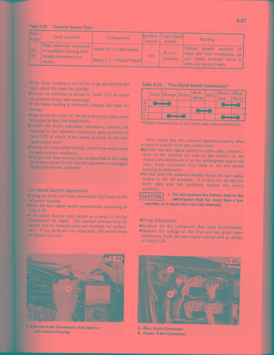

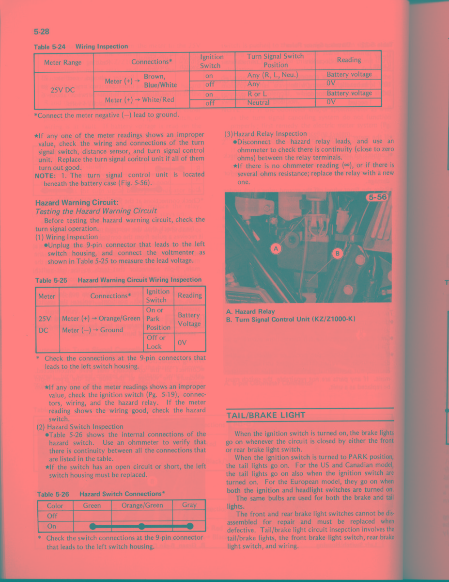

Here are some pages from the FSM on the flasher system and tests to run on it. Hope is provides more info for you.
