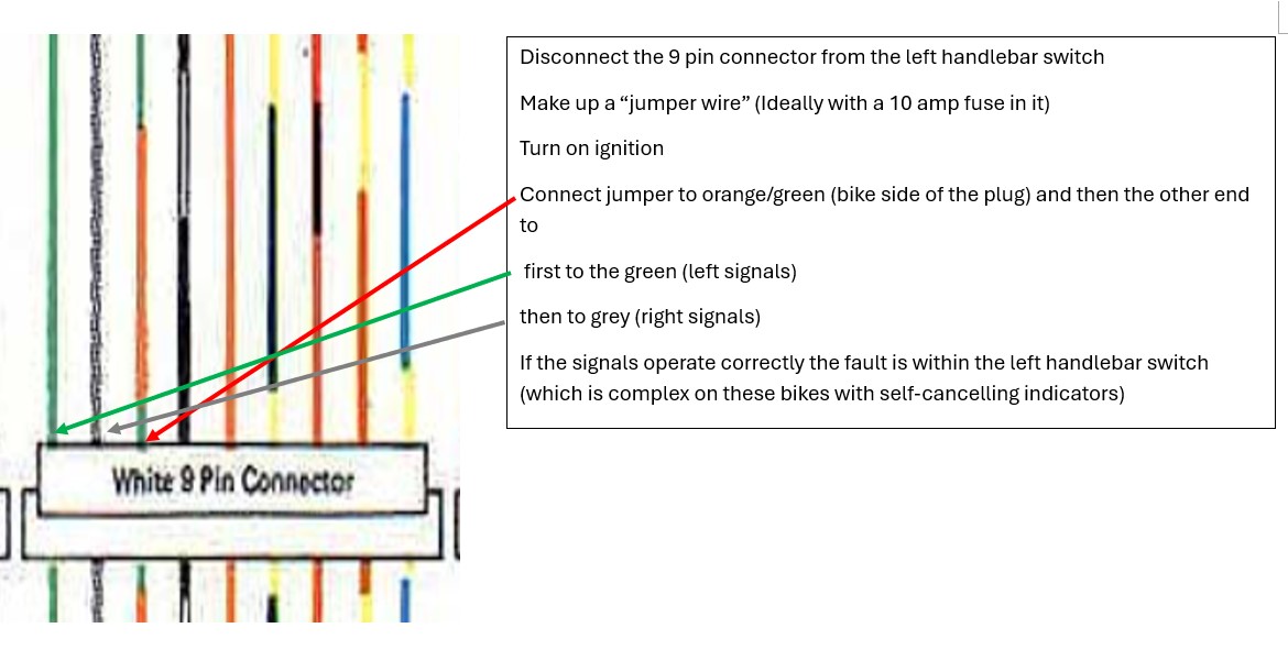

Gentlemen,
Stumped by some malfunctioning turn signal symptoms:
Bike is a KZ1100A. Functioned normally previously then sat for couple months in the garage.
>Right directional lights stays on when selected and left don’t light.
>Left directionals Lights blink normally but at the same time right lights come on solid.
Been through it tickling connections and no luck.
Ideas anyone?

Re: Turn Signal Malfunction
21 Oct 2024 13:19
21 Oct 2024 13:25
Yes it was the left handlebar multi switch!
