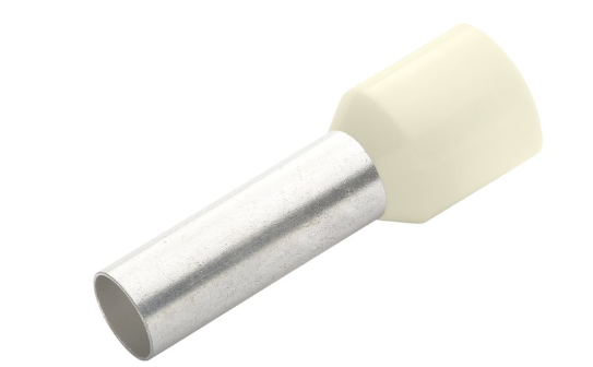

Use shoes on all end where you terminate the wire?

Use shoes on all end where you terminate the wire? Not sure what you mean by this ??

26 Sep 2024 01:22

26 Sep 2024 01:28Sorry still not clear what that is, do you mean were the wires go into the "M" unit ? - if so I would simply twist the end and solder it to prevent fraying

With the M-unit you want to use a special Ferrule Crimper to crimp the ferrules onto the end of the wires. It gives a much more secure connection.
Don't take shortcuts.

26 Sep 2024 05:58So does the "M" unit come with ferrules ? (every day's a "school day" )With the M-unit you want to use a special Ferrule Crimper to crimp the ferrules onto the end of the wires. It gives a much more secure connection.
