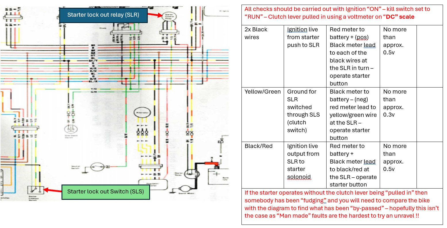

The lights dimming is normal due to the load on the battery (which at 11.8v is low) if you download the fault finding guide in my signature there is a generic starter circuit “test plan” towards the end
let me know how you get on, if you are still struggling I will give you some guidance (PS if the lights dimmed without the starter operating we may need to look a little deeper)

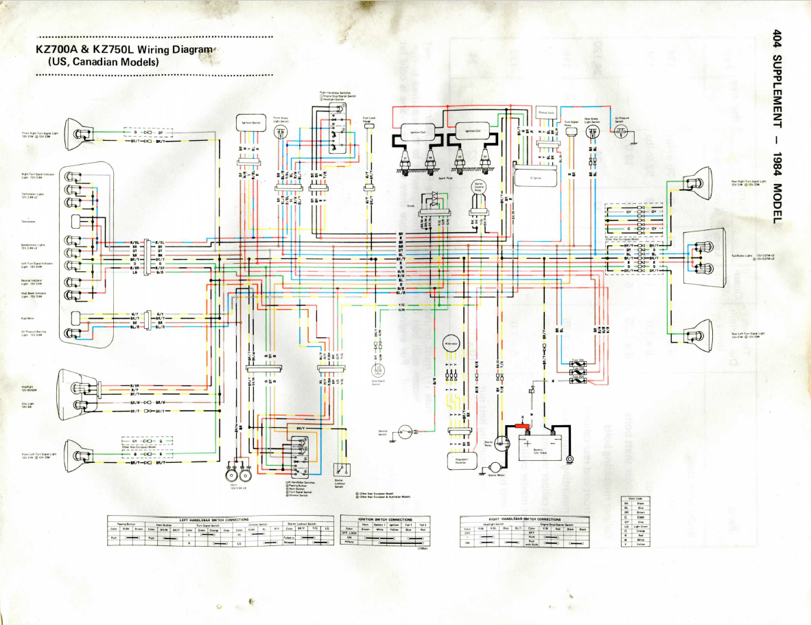

Do you have a wiring diagram for the 700 (none of the earlier diagrams I have looked at have an additional relay)

12 Sep 2024 03:58 - 12 Sep 2024 03:59It has a "starter control relay" per the diagram. one of these: www.partzilla.com/product/kawasaki/27002-1051

- Posts: 6940
- Thanks: 4357
Re: no crank, only when cold
12 Sep 2024 05:06

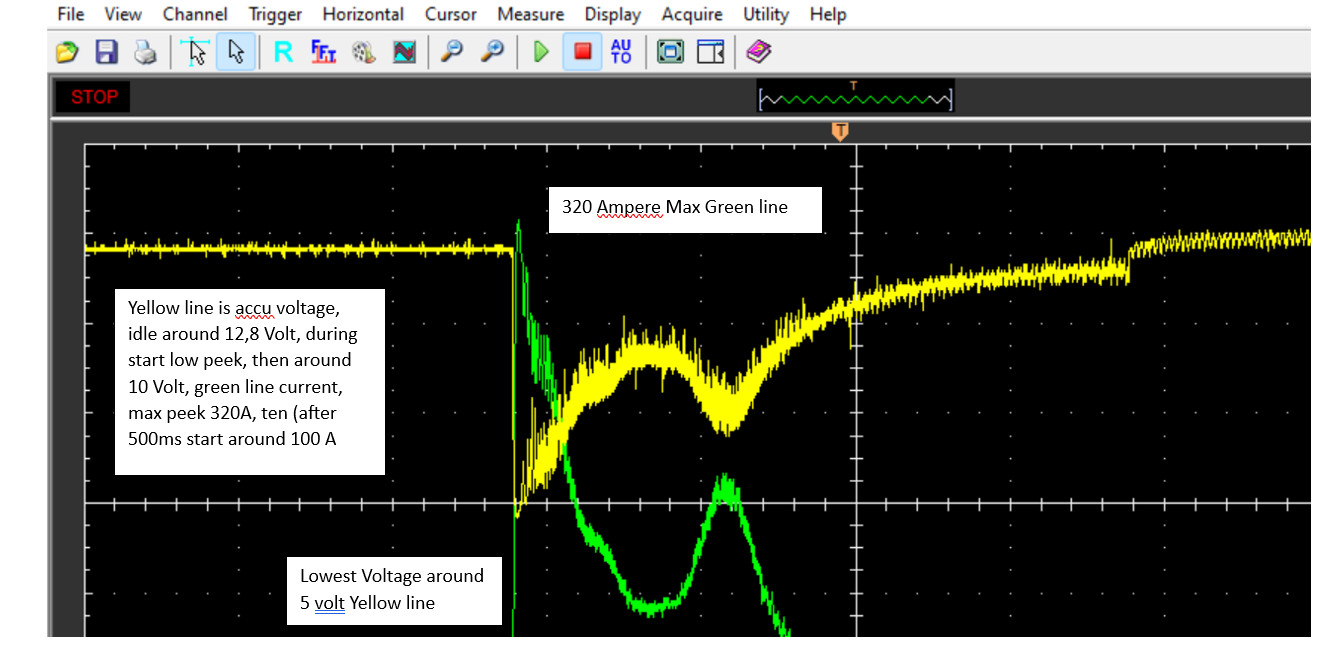

I have some issue with the starter, cracks the engine when cold (slowly), but when engine warm, sometimes no cracking, Today I put a other (revised) starter inside, now problems are solved, good starting cold and hot, also the starting rpm is much higher.
I made a scope grap of the current and voltage during start (with the new starter), see attachment
