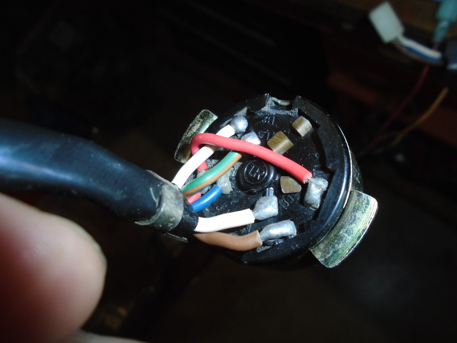

The solder joints in the switch are now 47 years old, and are getting more brittle by the day. A loose one could be the culprit. Whether a loose connection or a shorted wire, tending to it sooner rather than later could prevent damage to various electrical components, or even a fire.

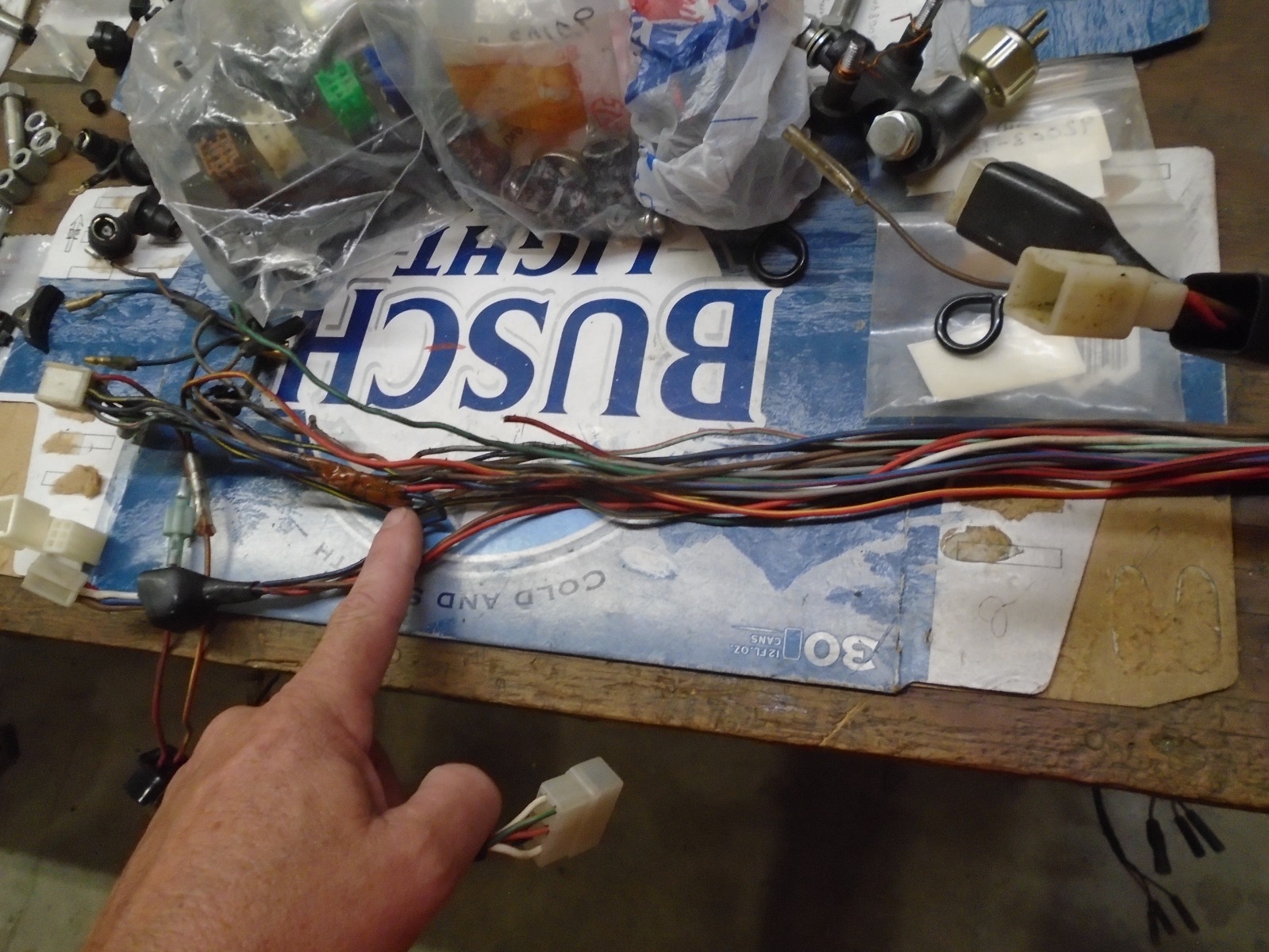

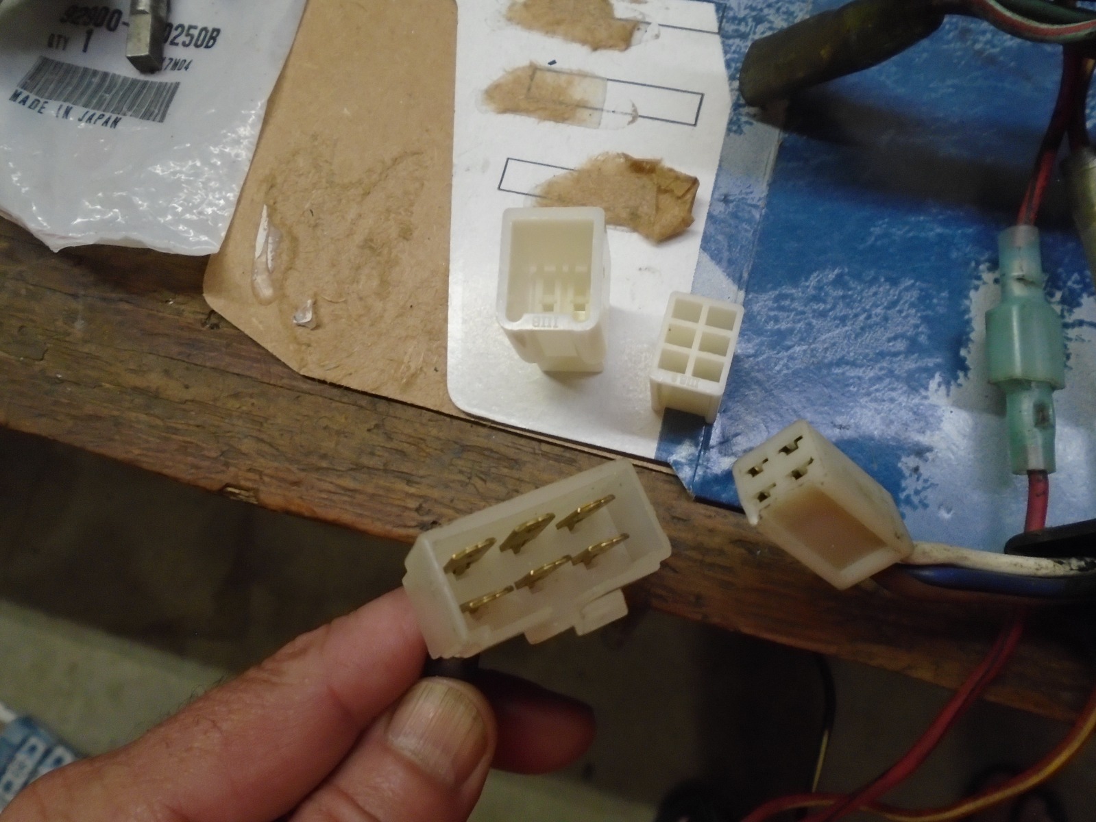

KYKZ this what i "believe" Texas is referring to he mentions solder joints. Note there are basically 3 different connector block types on every Z1-KZ. 4-pin, 6-pin small non-latching and the bigger spade Z1R 6-pin style. You will have the small 6-pin because the KZ1000 had a 3-fuse set-up. Note the picture of all those solder connections on the back of your switch, they indeed can wander off their respective places over time. I've seen a lot of this "factory' soldering so weak that while wire had solder on them barely any solder on their respective collets of breadboards. Also, look for distorted wiring insulation on both harness and switch side around connector block connection. Although and hopefully not your problem, wiring inside that shiny sheath that comes from under tank to headlight bucket gets a workout over all those years of making turns. Inside that sheath they also had connections that can fatigue and fail. Kawasaki harnesses used a crimped sleeve with no solder, Honda used just solder but that's a whole different story. As Texas referenced, fire, anything can happen but highly unlikely. Unless you used tinfoil wrapped fuses or waay too big rated ones.
