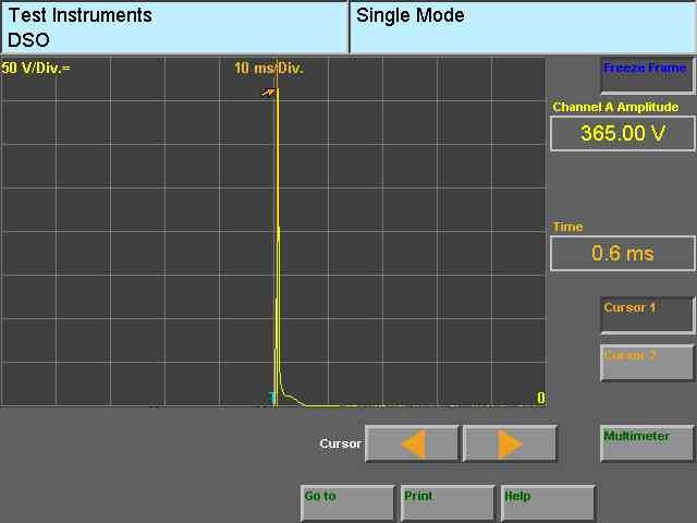

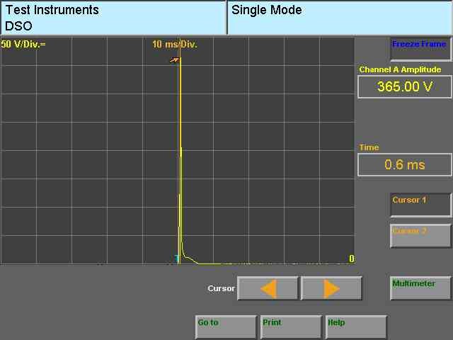

While I was working on my electrics today I noticed something with the relays I will be using that I thought I would share with you, have you ever noticed that some relays have a "Resistor" or a "Diode" in the primary side of the relay ? If so have you ever wondered why it is there ?
Lot's of you guys are fitting more and more electronic devices to your bikes (ignition modules, instruments, system controllers etc) so I thought it made sense to cover this topic - the old motto "better safe than sorry" comes to mind as diagnosing the potential issues that can be caused by using "un-protected" relays with electronics will catch out even the most experienced enthusiast
These relays have the resistor or diode to block "reverse voltage spikes" when you turn them off - sounds strange I know but the winding in a relay generates a magnetic field (just like an ignition coil) which when turned off inducts a voltage (same as a coil secondary/HT)
I have included a screen shot from an oscilloscope which shows a regular 4 pin autoparts store relay inducing a momentary spike of nearly 400v
This is the potential scenario if not using a protected relay with electronics
You fit your new gizmo with a regular relay - turn it on, works great - turn it off - turn it back on and it doesn't work (the 400v back EMF has fried it) so you do your checks, relay works, wiring is all good so "gizmo" must be faulty. Take it back to the store and get a new "gizmo" fit it, turn it on, happy days, turn it off and "poof" new gizmo is fried
Do your checks, wiring is ok maybe a "bad ground" no that's ok - so back to the store. Store guy is not happy to replace another gizmo but does begrudgingly. You take it home fit it and guess what happens next !!!!!!!!!!!! This time store guy tells you to f#*k off

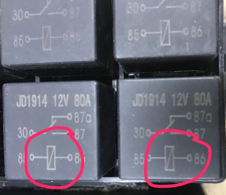

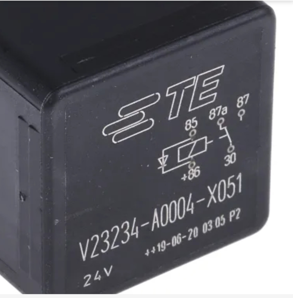

Re: A word of warning !!
07 Jul 2024 17:44
I thought the symbol between 85-86 was a coil. Are you saying it’s indicating a diode?

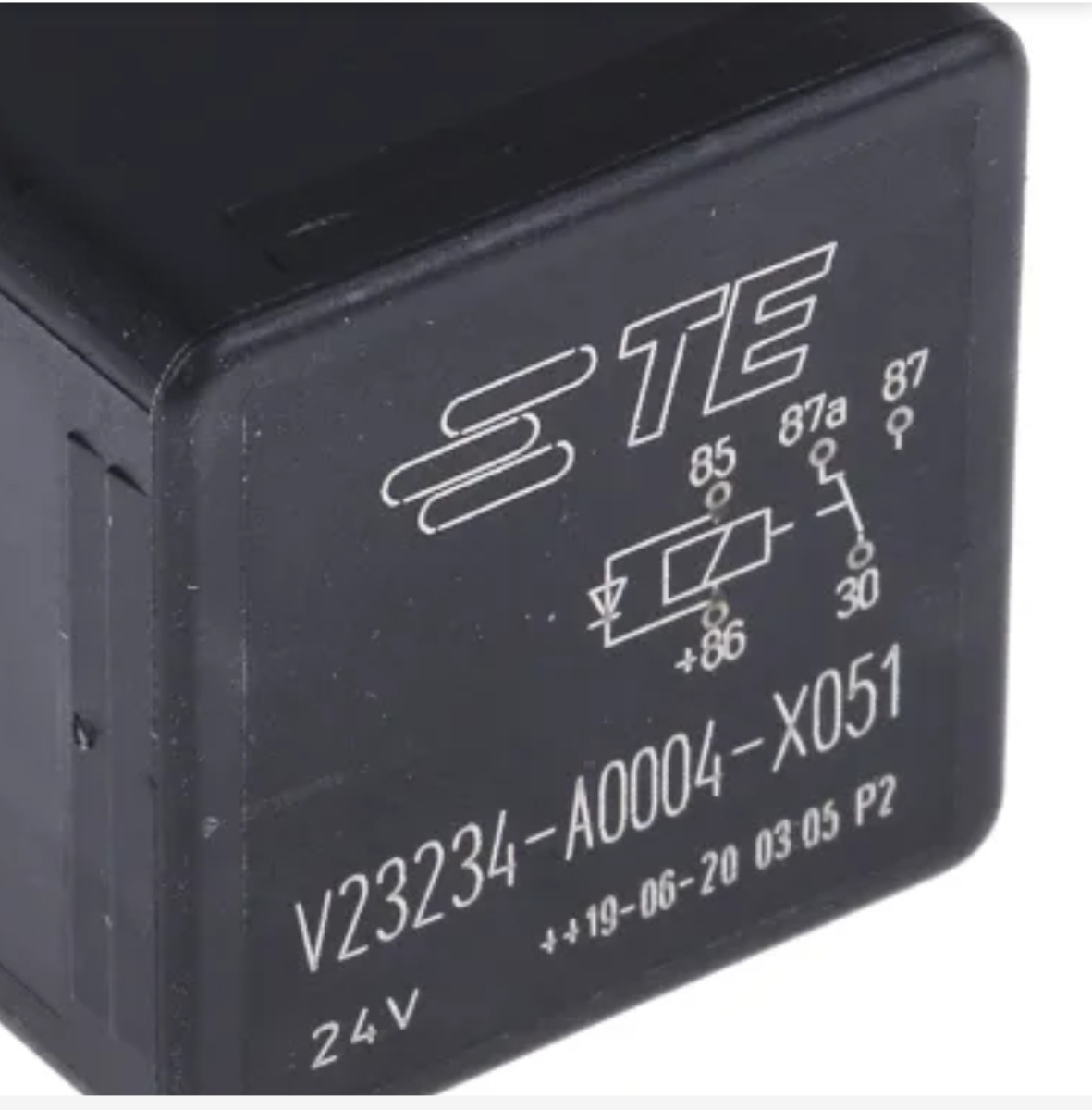

- F64
- 81-KZ440D2
- Posts: 1157
- Thanks: 418
07 Jul 2024 17:55
07 Jul 2024 18:47With the one you posted you need to be mindful of coil polarity?
- F64
- 81-KZ440D2
- Posts: 1157
- Thanks: 418
07 Jul 2024 20:17
Yes, with a diode inside the relay, you need to have the correct polarity on the relay's coil.
There is a "+" sign next to the 86 terminal.

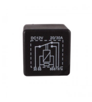

- Posts: 6341
- Thanks: 4006
08 Jul 2024 00:21Good spot Mikaw (I must have been having a senior moment with that diagram) this is what a relay with resistor looks likeI thought the symbol between 85-86 was a coil. Are you saying it’s indicating a diode?

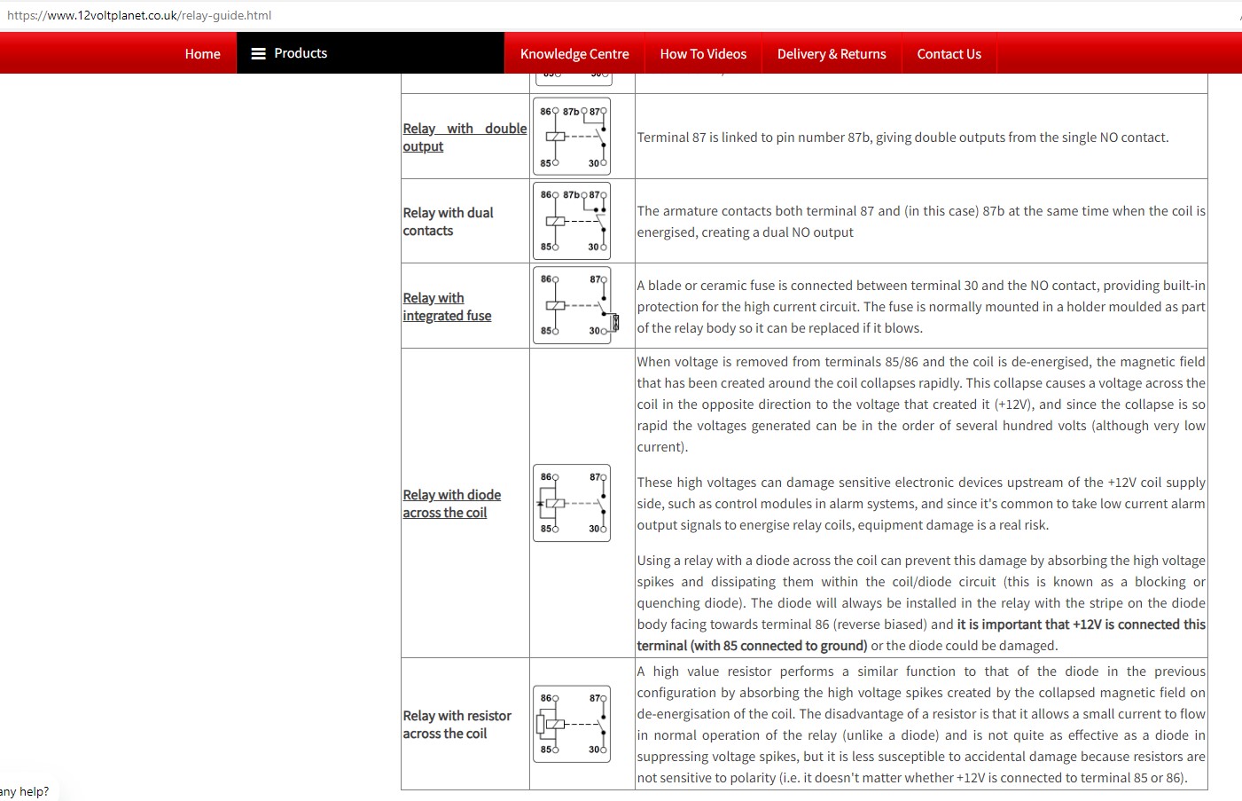

- Posts: 6341
- Thanks: 4006
08 Jul 2024 03:10I don't know the value of the resistor unfortunately, only that it is greater than the resistance of the relay coil. Because it is in "parallel" with the relay coil and electricity is lazy, under normal operating conditions the current passes through the relay coil (the path of least resistance) so any load increase is negligibleslmjim here. Twenty+ years career in photocopier & printer hardware before moving into print / scan / fax Network Analyst arena.
