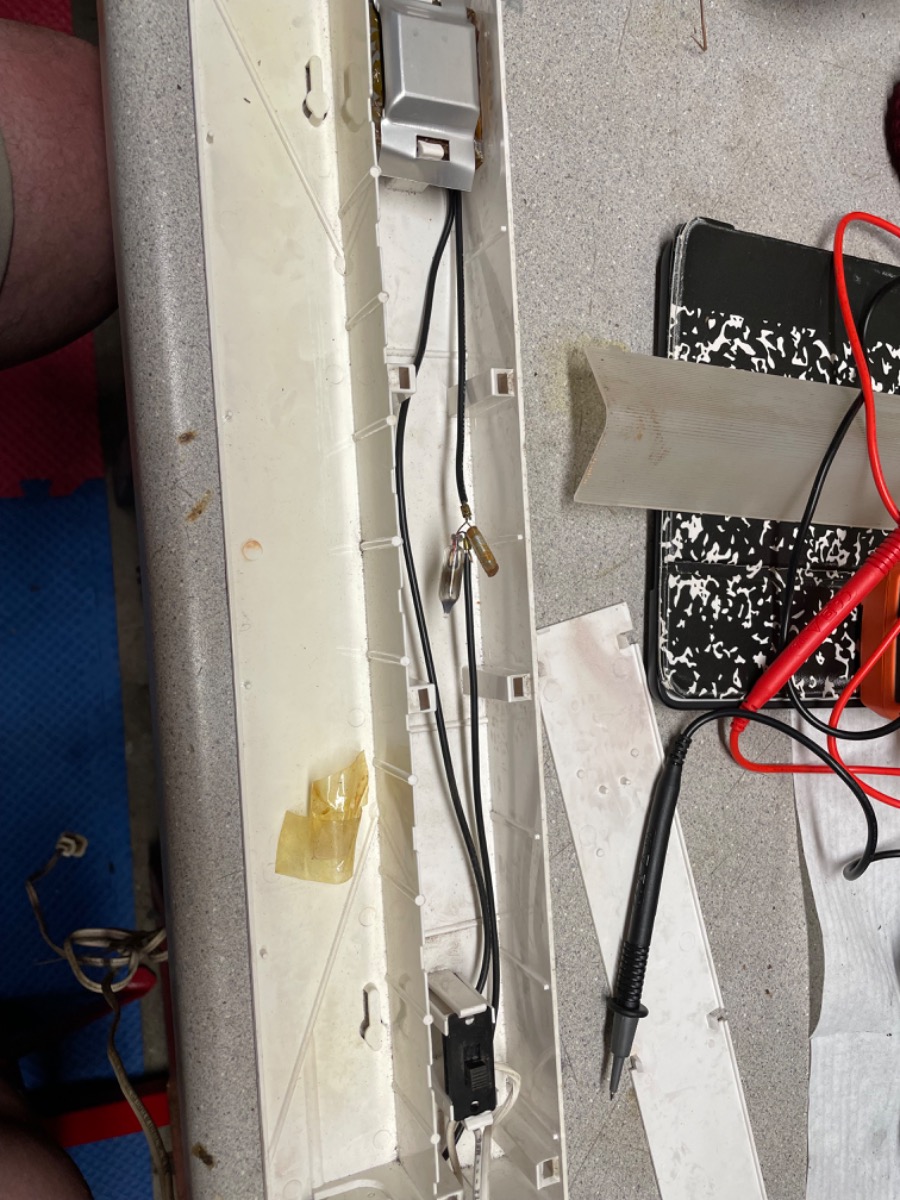

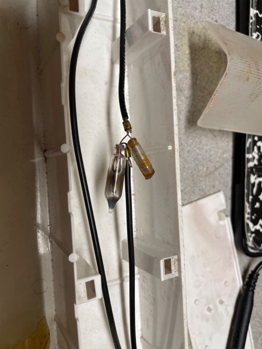

I have this cheap little fluorescent light fixture that quit working. I opened it up and found this weirdness. As you can see there is a resistor and small light bulb wired inline between the transformer and switch . What the heck are these for?

It looks like a small inductiv coil with a ferrit core ( periodic element Fe = pure iron with no carbon) that excited the glow bulb.

How old of a light is it? I think the little bulb is filled with a gas and works as a preheater so to speak and start the bulb glowing.

07 Jul 2024 05:14Have to concur with that. The neon bulb & other components likely mimic the circuitry of the old-style two-pin 'can' starters that are easily replaced in older fluorescent fixtures.How old of a light is it? I think the little bulb is filled with a gas and works as a preheater so to speak and start the bulb glowing.

It is an old fixture to be sure, but I do not know how old. That those two parts once performed the function of a can starter seems like a reasonable theory. I may look into converting to led, but I suspect the cost may well exceed a new fixture.

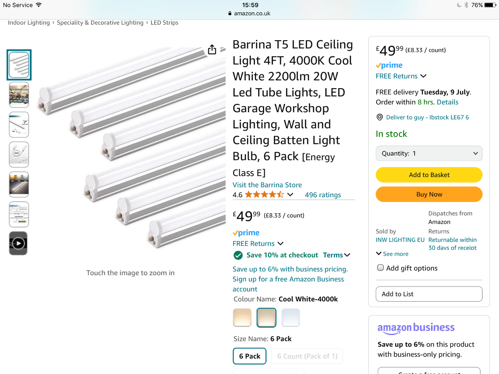

07 Jul 2024 08:01They aren't expensive at all (or don't have to be) I have the below in my shop which have been up for over 2 yeamrs without issue and they cost penny's to runIt is an old fixture to be sure, but I do not know how old. That those two parts once performed the function of a can starter seems like a reasonable theory. I may look into converting to led, but I suspect the cost may well exceed a new fixture.
