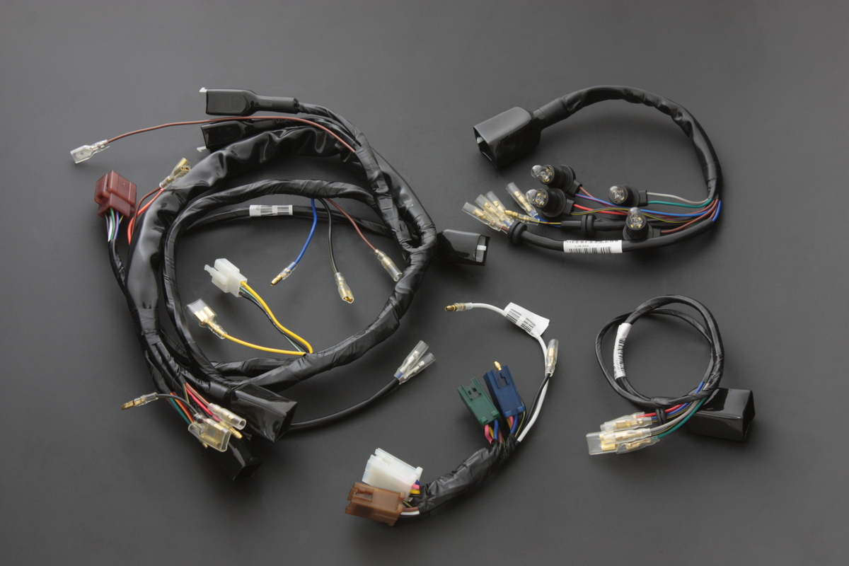

A complete Z1 900 wiring harness (175 $) would be a good starting point.
z-fever.de/shop/en/?cat=c140_KABEL-KABEL.html
