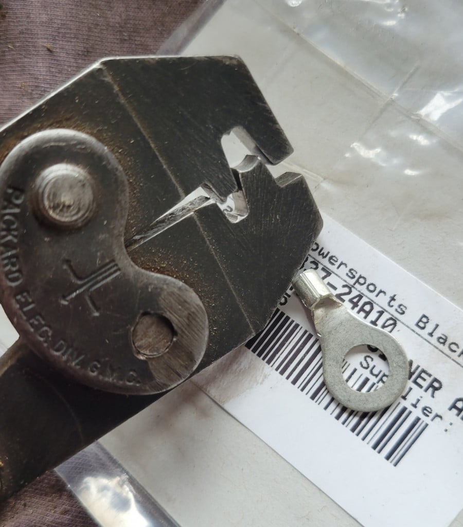

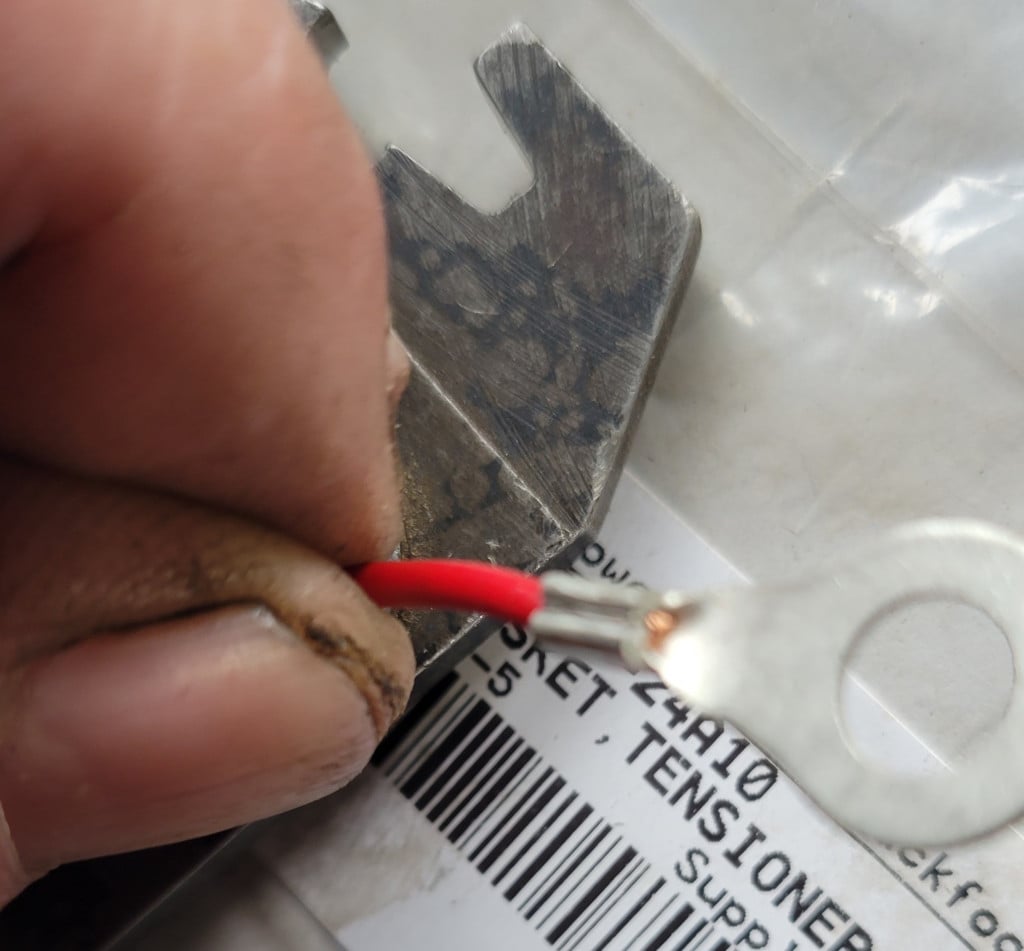

This are the only crimp tool that I use to produce a factory equivalent connection .... been using the same tool for 30 yrs .... the tool is Kent Moore but I am sure there are other tools that will produce the same result.
