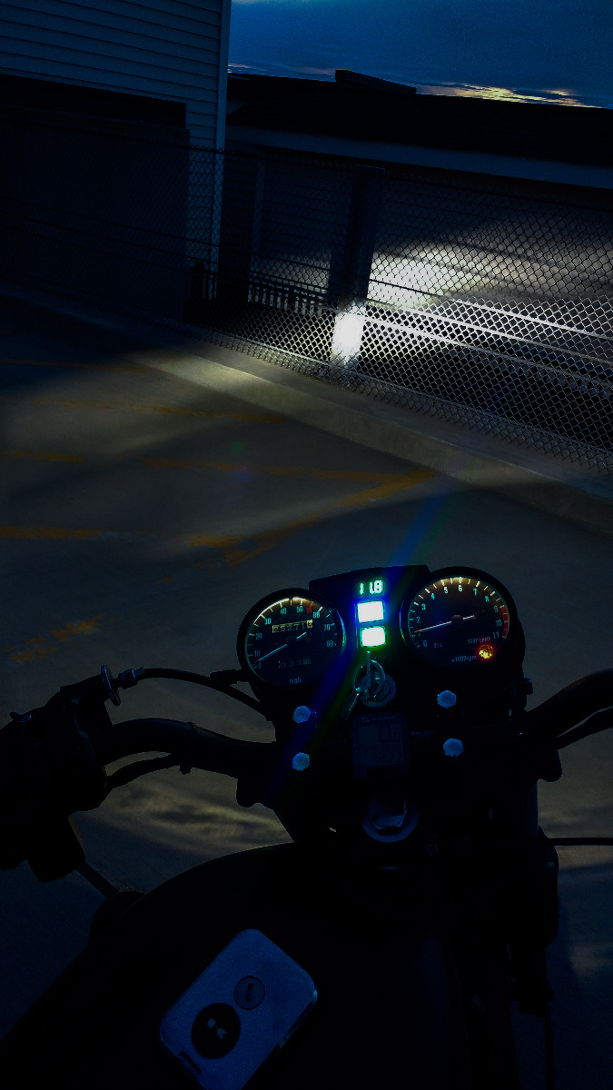

Might as well post a photo of my led dash lights instead.
The green neutral light and the blue high beam lights are overexsposed in the image. They are pretty bright.
