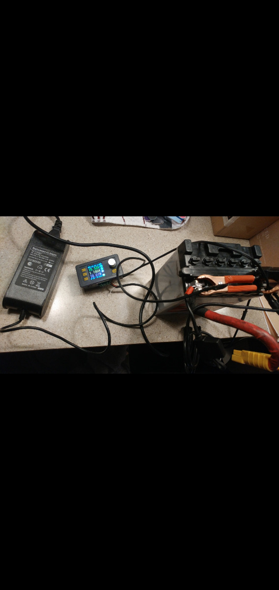

You can get a voltage regulator for about $30.
www.amazon.com/DROK-Converter-Adjustable...0BQBXMH67?th=1&psc=1
Hook it up to your 6 volt or 12 charger.
You can control the voltage down to about 0.5v dc.
Plus you contol the current.
I just hooked my regulator up to a laptop charger to charge my 12v battery.
Battery University has a lot of info on charging batteries.
batteryuniversity.com/article/bu-405-cha...-with-a-power-supply
