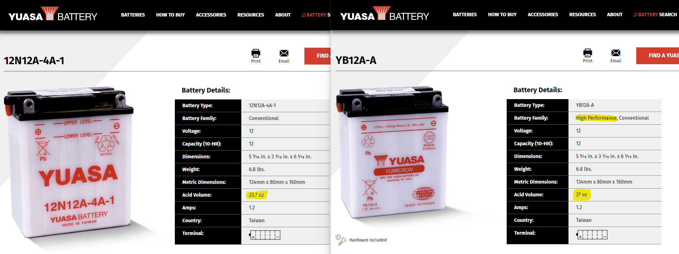

I think he wants some help to understand the meanings of the different parts of the battery model number (maybe so he can find an equivalent battery from another manufacturer).
I don't know exactly what the other fields mean, but that is a Yuasa part number so anything 12V and having the same exterior dimensions should work for what he needs. The other main point will be the location/type of electrical connections on the battery: they will need to be the same as on the current (heh) battery, but there shouldn't be too many options for that.
Here are the details (with a picture of the terminals) from Yuasa: www.yuasabatteries.com/battery/12n12a-4a-1/

The OEM number battery is YB12A-A. 12N12A-4A-1 is the same size and configuration, but seems to be built to a lower price point.
