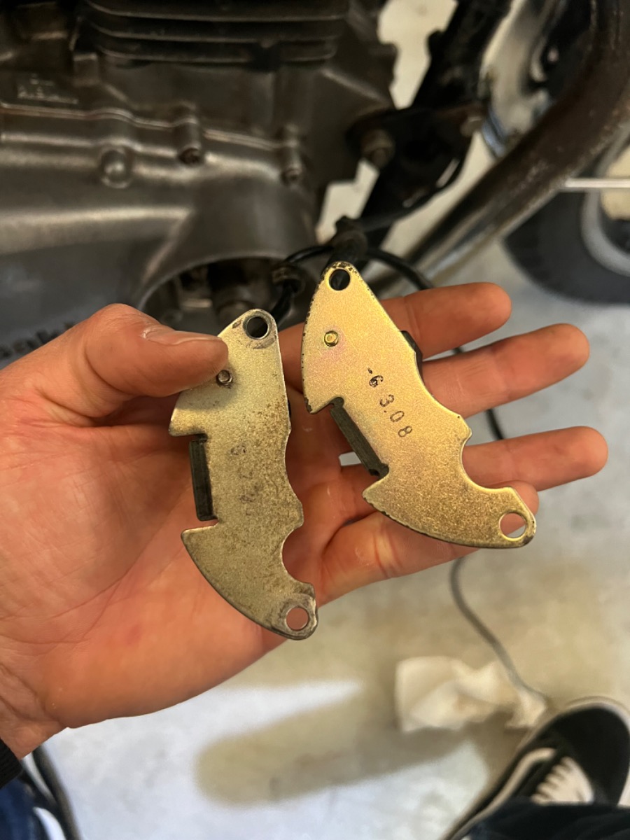

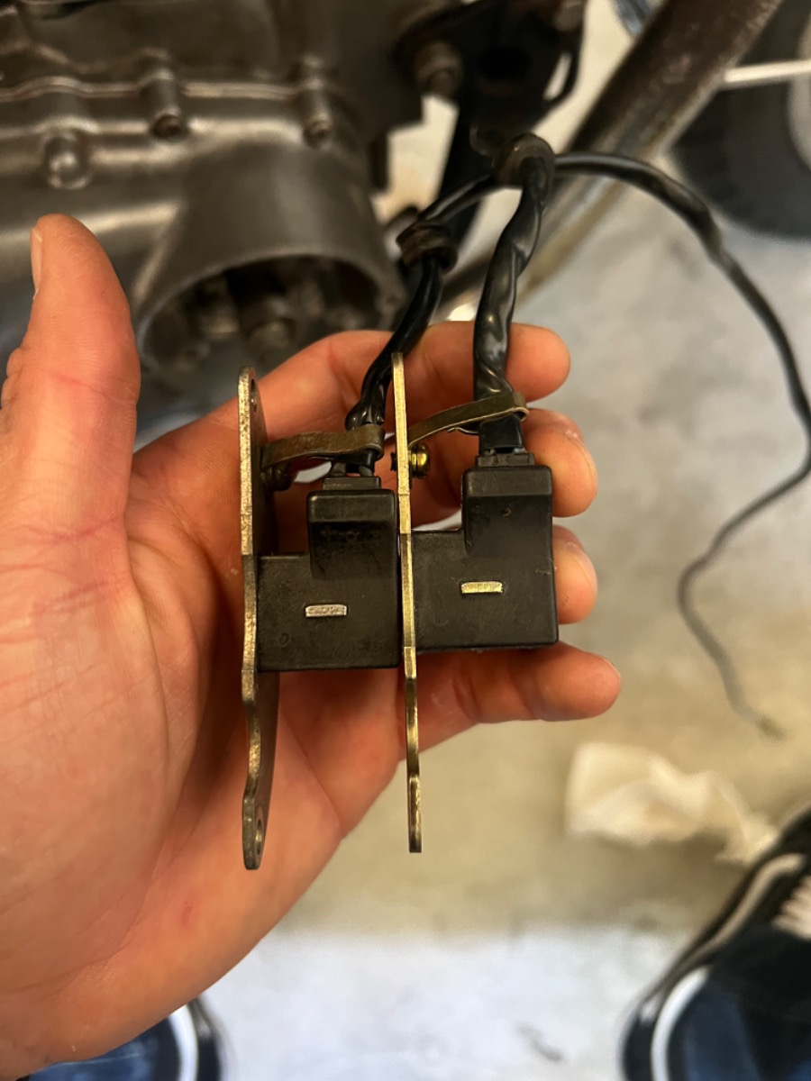

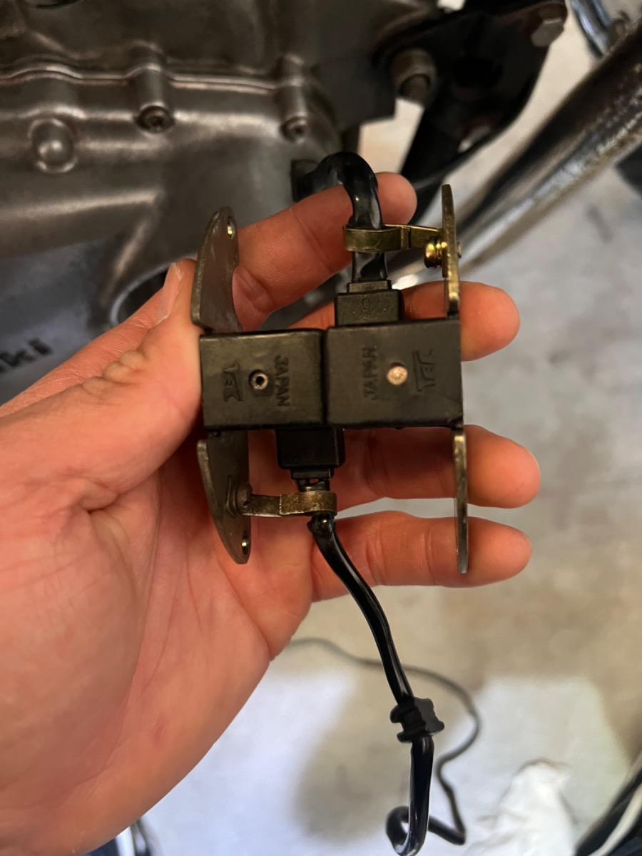

Here is where things get strange: I tested my pick up coil resistance, when cold and tested 460 ohms (good) but when hot I got no reading. I purchased OEM
pick up coil (Very pricey) part number 59026-1010 (same as the one in my bike). Checked the part with ohmmeter and tested good. After Installed it she didn't wanted to start. I tried a couple times but I stopped as soon as I got a very loud backfire. Checked if I had spark and spark was there. It looked like and sounded like the timing was off. I removed the new coil, put the old one back and she started with no problem.
I attached some pictures of the old and new pickup coils.
Any ideas of what can be potentially wrong?
