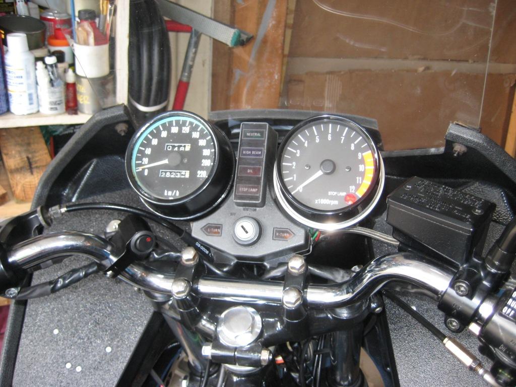

converted mine z650 by using internals from a suzuki gsx750f, based on an idea by 'injected'
hardest part was trying to remove z650 needle broke the spindle
