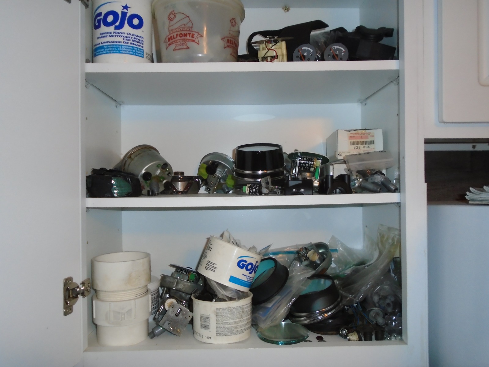

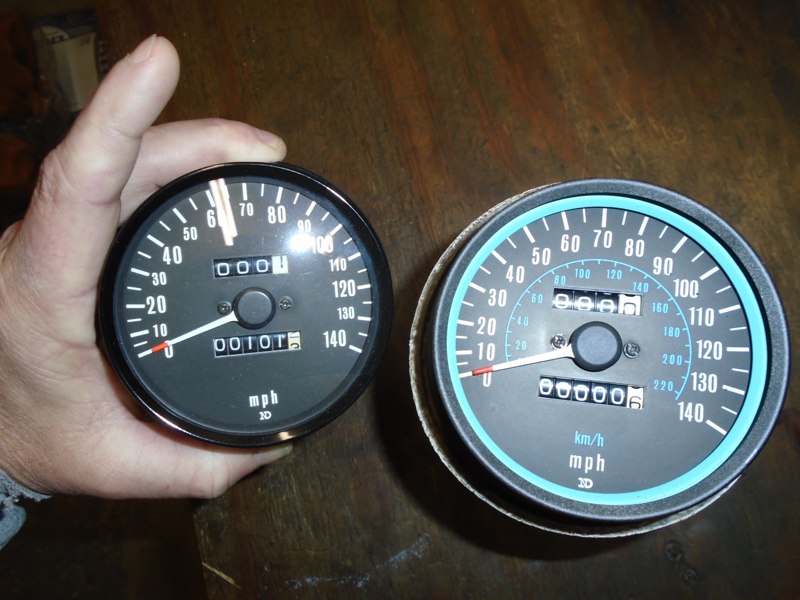

These are a couple examples if they are mechanical, the rare beveled glass 1977 and later dual KMH/MPH. A one of my cabinets jam packed with bits of the same.

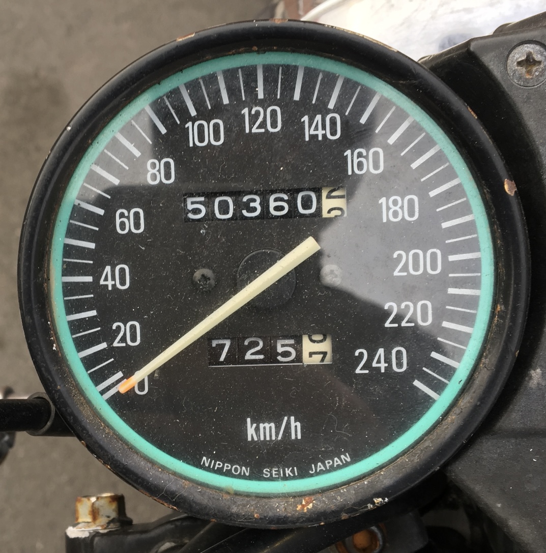

23 Jan 2024 00:40

Well darn, You have the newer style. And apparently overseas or Canadian. At least those styles are abundant and fairly cheap.
