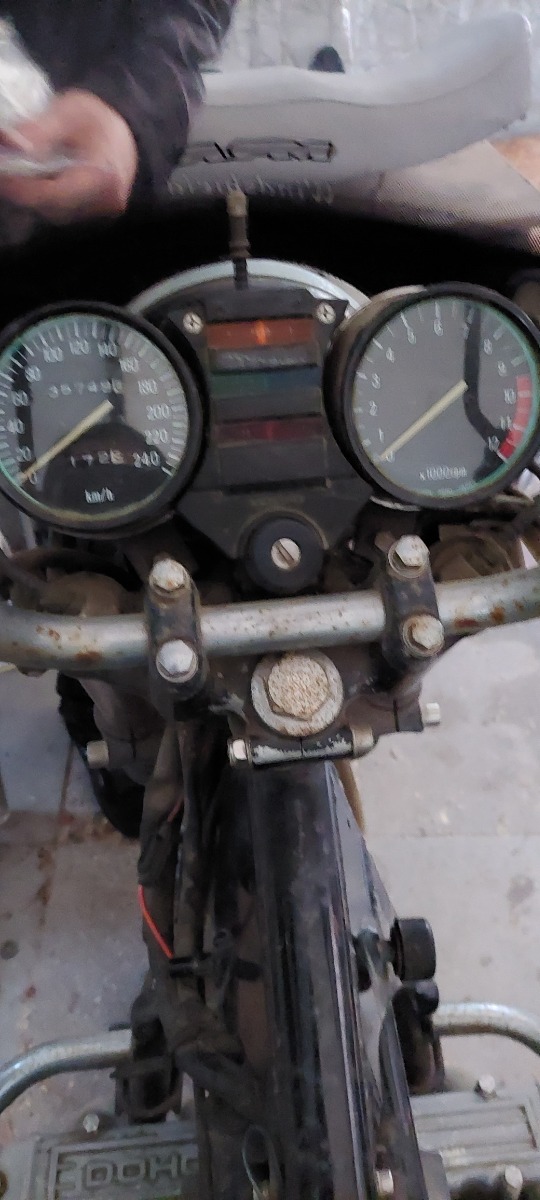

16 Jan 2024 13:20 - 16 Jan 2024 13:22So I kinda already asked this on my build thread but to give it its own thread might be a good idea.
I am looking to find out about the cover which has a voltmeter in it. Can I use it on my bike ?
Anyone know if its just the cover to swap or the whole unit?
Is it a hard job?
Thanks and regards
Larry

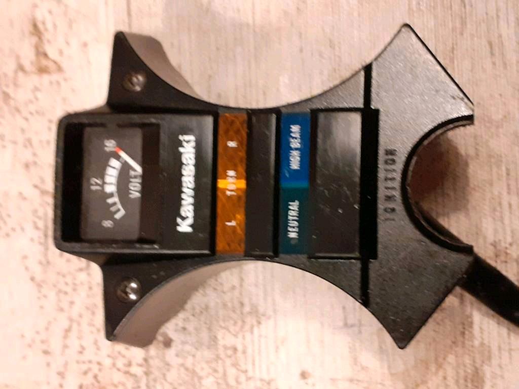

I don't see any reason why not, you will have to check a wiring diagram to see if the voltmeter picks up it's live and ground internally from the oil pressure/ neutral light supply or if it needs a separate wire running

The really question is whether the version with the voltmeter has an oil and neutral light because I can't really tell from the photos I got it's to dark to see and I don't have any idea.

It would need to be the complete warning light unit (which will have the required warning lights - oil/neutral etc) other members more familiar with the model will be able to confirm

What motorcycle do you have? Guessing it's a 750E. On some models the part is listed as a pilot box cover. Your motorcycle may have the oil warning light at the center pilot box, but the donor part does not have a spot for an oil light (it would be at the tachometer instead).
EB pics can be handy in figuring out what the pilot lights are.
Meter pics on pg 8 of this topic might help >>> Nessism KZ750E >> www.kzrider.com/forum/11-projects/604901...ject-thread?start=84

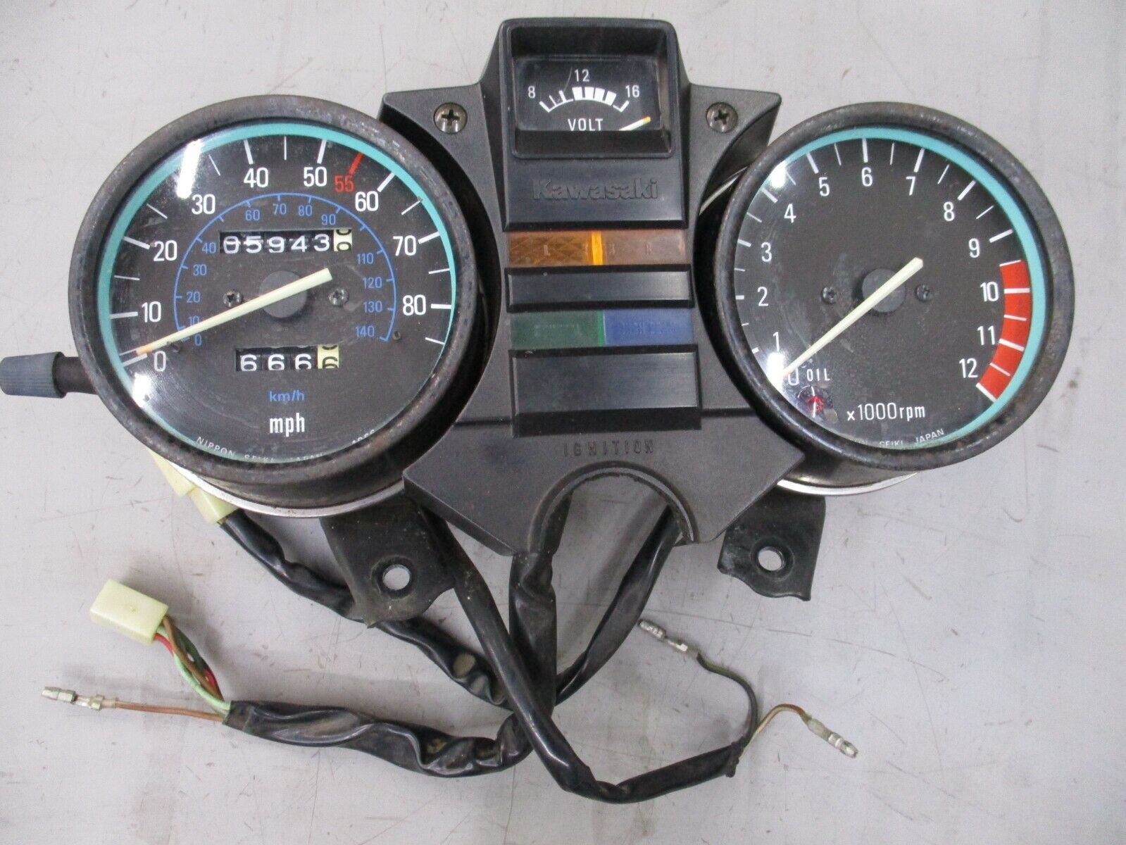

The 750 dash cover in your post had the oil pressure light in the tach shown in this picture :
You could easily add a red light to that dash cover shown and swap over the wires from your original oil pressure lamp - Ebay (186241200092) or your local auto parts supplier.
You must be in Europe as you have a KPH speedo.
