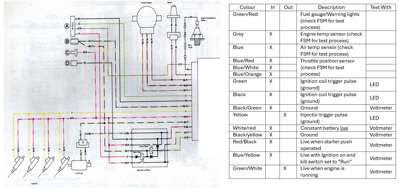

So I have had a look at the 1100 wiring diagram (don't currently have a 1300 one so assuming the same system is used given it was introduced on both bikes around the same time)
Are you comfortable with a digital multi-meter and do you have an LED or LED test light (remember they are polarity sensitive when using) I think the battery short is a bit of a "rabbit hole" generally a battery short will either start a fire or blow electronics and you have substituted all the electronic components from your bike.
With these type systems in my experience the most efficient way to diagnose is to systematically work through all the "inputs" and "output" to the ECU. If you work through the below and let me know what you did and didn't have at the ECU then we can look at the next steps (sounds like a bind but will take less time than you have spent on it already !!)
