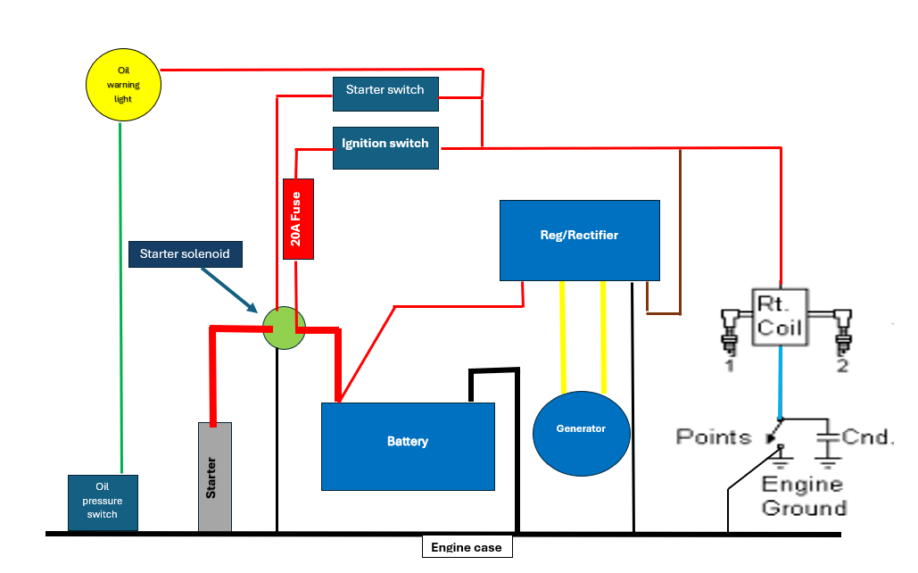

Is it wired exactly as I showed you now it's in the buggy?

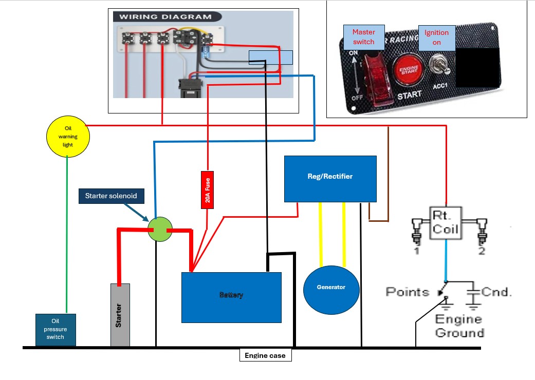

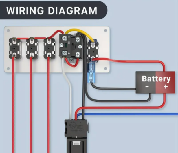

I don't have Ohm Meter, and unless I did something wrong I have it wired like you showed me. It took a couple tries to get the ignition switch panel to work because I had to somehow combine your wiring diagram with this one

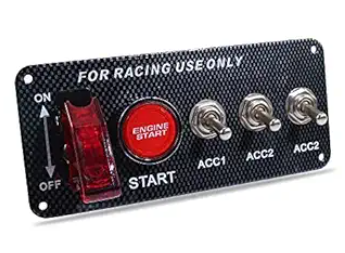

Have you got a picture of the front of that panel, also check if the coil is still getting a live when the ign switch is off
Also where does the blue wire go?

I have the blue wire and the red wire from the ignition switch connected to each other going to the positive on the starter relay, and going to the ignition coil + rectifier. I marked where it is on the starter relay. This is the only way the start button would work for me

Are the switches illuminated ? Just wondering why there is "grounds" involved

Yes the switches have lights on them
