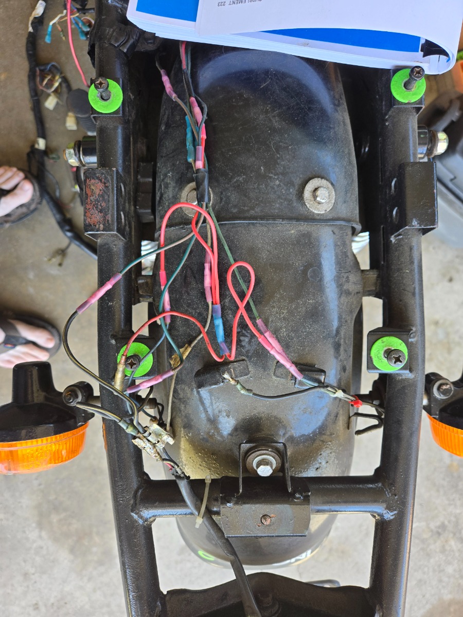

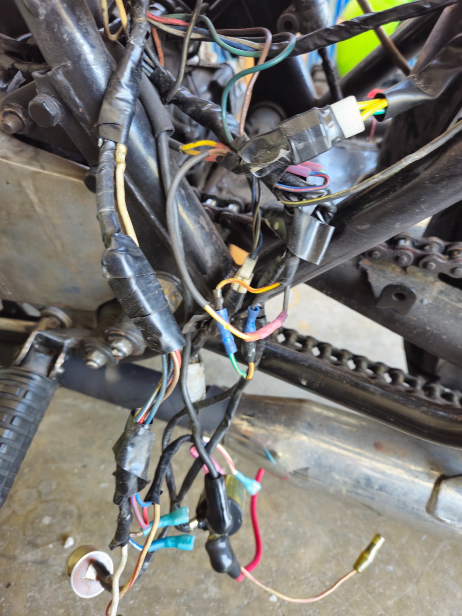

So I acquired a seventy seven that you guys have seen before, Because I post pictures of it and i'm down right in love with it. The previous owner started a hackery on the wires to do a 1/2 ass cafe Racer. Thing is and now i'm finding problems the more miles I put on it. Yesterday I lost my neutral light. Is today I lost the break lamp light. I fear it's only a matter of time before a loose connection or a electrical issue causes something dangerous.
The wires have been hacked there's electrical tape stuck to things some Wires are crispy.
Electricity and wires are magic and voodoo. I am fully willing to pay the money for somebody to build a harness or direct me into the place to acquire one.
It is a 1977 KZ750 twin. A simple thing, that has had a rough past life. All 34000 original miles.

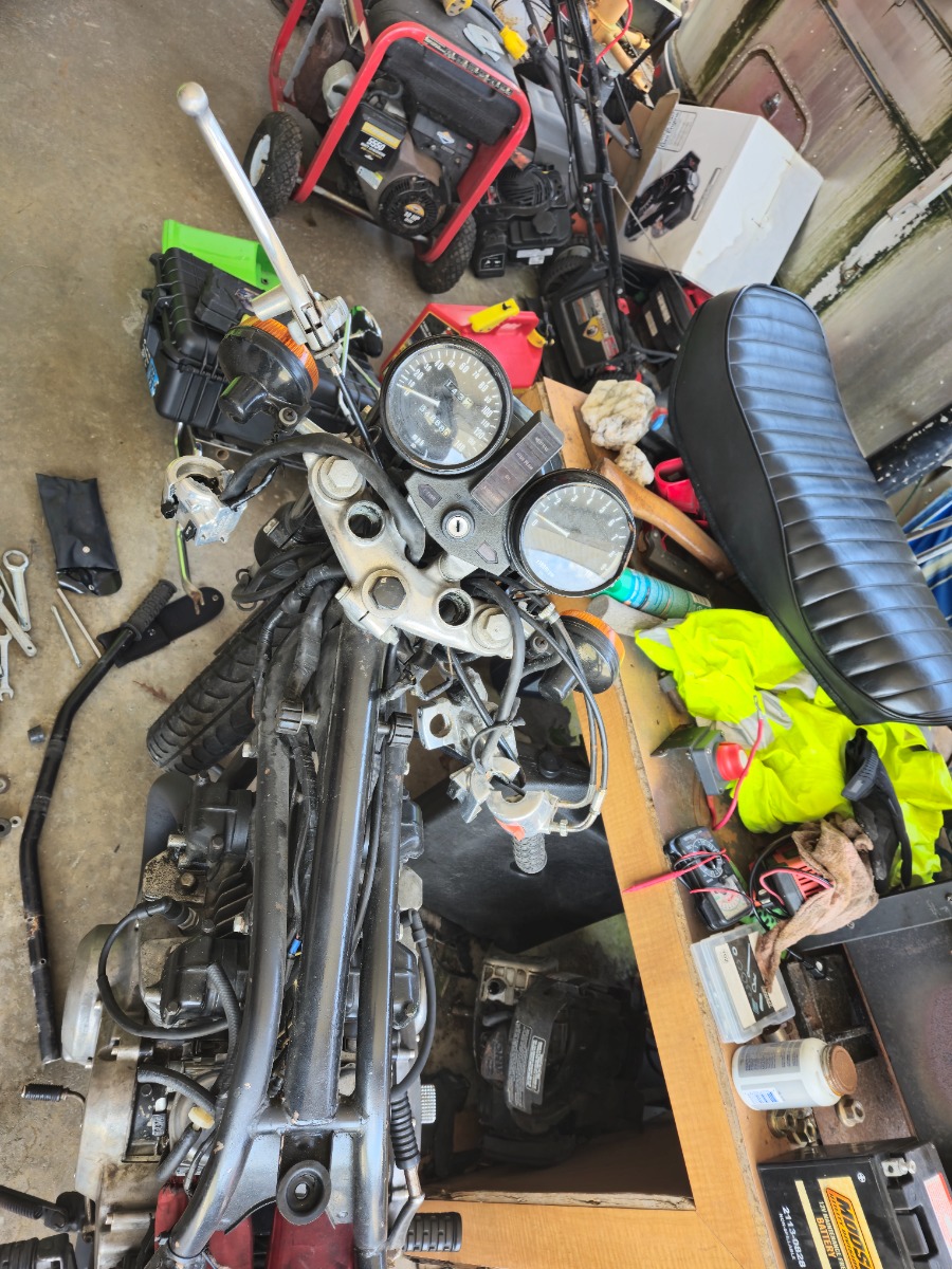

At the moment I have the bike striped down, no plastics. I have the tank off. I am looking at all of the electrical tape wrapped and twisted..melted and singed here and there.

It would be handy to verify what wire harness you got. Assuming it's correct....
You're going to have to be methodical and start labeling everything. probably not going to figure it out in a weekend or even a week.
I would start at the front of the harness and see if you can figure out what plugs into it. and keep plugging away at it. ha ha.
Going by the size and shape of the plastic connectors, some stuff should be obvious.
The more stuff you figure out, the unknown stuff should be easier to pin down later on.
The parts diagram drawings might help. partzilla would probably be best >> you could open a window for each drawing. electrical. meters. ignition. generator. etc etc.
If the wire colors are hard to see, try cleaning w silicone spray or something. I use Liquid wrench silicone spray lubricant on a lot of stuff. metal, plastic, rubber, wires.
ps: adhesive address labels from the office supply might be handy. I looked for wire harness labels but didn't find anything, not cheap anyway.

I would suggest first laying the new loom on the floor next to the bike, when it's layed out where things go becomes more obvious. Then sort out your battery leads up to the fuse box, starter cable and starter solonoid. (Don't connect the battery at this stage) then build from there constantly referring back to the diagram
PS: if you can work out what the switches are from and want to retain them, sort a wiring diagram for the donor and I will be able to tell you what connects to where on the Kawa harness
