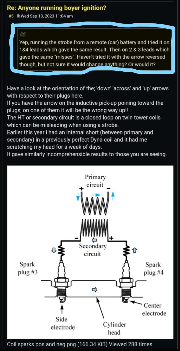

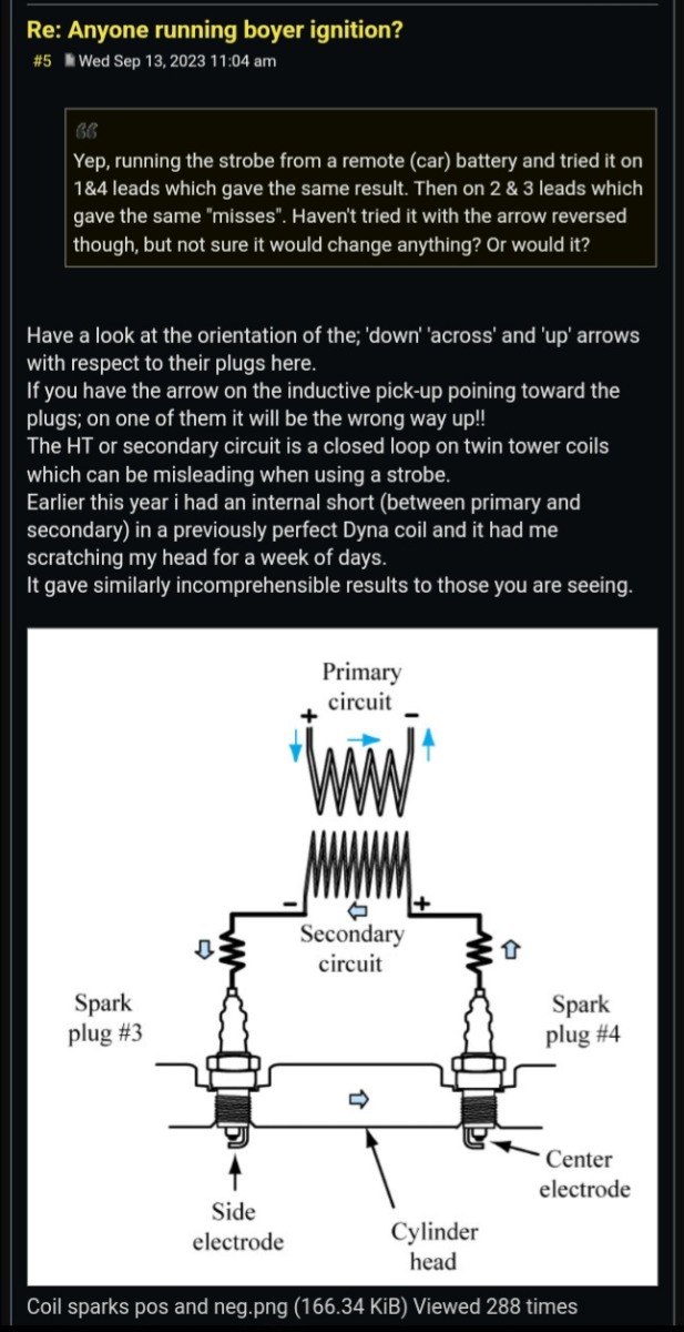

On the clamp of the strobe you'll see that it has an arrow on it. On which ever lead flashes consistently the arrow is likely pointing towards the plug. When you switch it to the other lead which way is the arrow pointing?
If it's pointing towards the plug again try reversing it so it points towards the coil.
Seems counter intuitive but there was a discussion about it on another forum and a member eventually came up with a diagram to show that the earth flow over two coils works in a circle which affects modern strobes. I'll try and find which forum it was and post the image if I find it.

30 Oct 2023 07:48I am a long time "out of school" but it is my understanding that this phenonium is more relevant to later "coil per cylinder" type ignitions but I am happy to be re-educatedOn the clamp of the strobe you'll see that it has an arrow on it. On which ever lead flashes consistently the arrow is likely pointing towards the plug. When you switch it to the other lead which way is the arrow pointing?

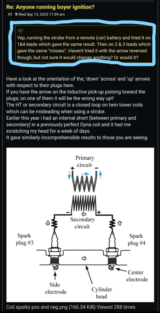

Found it!
Screen shot of the comments and diagram. Take note of the differing arrow directions on the ht leads.

This doesn't make sense, the fault relates to 2&3 but not 1&4 these are separate coils so surely the diagram is irrelevant ? (wouldn't you expect the "bad" signal on one lead of each coil EG: 1&3?) also just to confuse things the diagram shows "electron flow" which is neg to pos as opposed to "current flow" which is pos to neg

That was not the issue on the original thread Guy but it was posted as a possible cause of the symptoms. It turned out to be coil 2 & 3 was breaking down but only evident at a narrow rev range.
I posted it as a possible cause for the symptoms/observations on this thread.
As it turned out on the thread I nicked it from it was not an issue with a boyer system ( sort of.) A po had managed to configure a micro 3 boyer system box designed for triples with 3 pick ups to run a four cylinder motor with 2 pick ups.
Don't ask me how he did it but it worked once the coil was exchanged.

Makes sense Warren, some of these postings can cause confusion some "wasted spark" ignitions fire adjacent cylinder (1&2 - 3&4) so one is on the power stroke and the other is on exhaust to help reduce emissions with a "secondary burn"

I will try it with the arrow pointing towards the coil instead of the plug probably this is why when I used the old type of ignition light it flashed constant as it should
