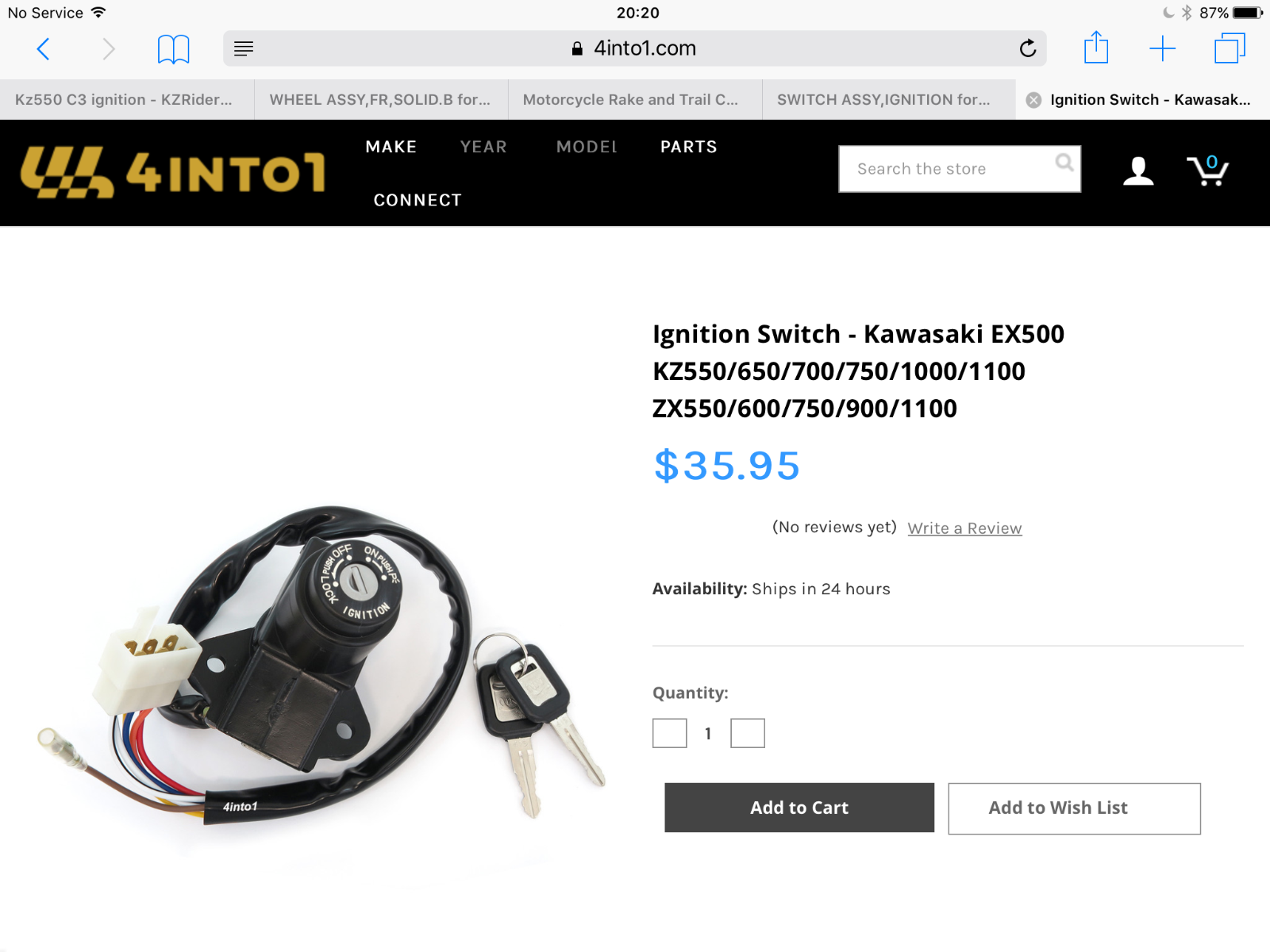

So, would I be right in saying that this is the same switch as those that you directed me to?

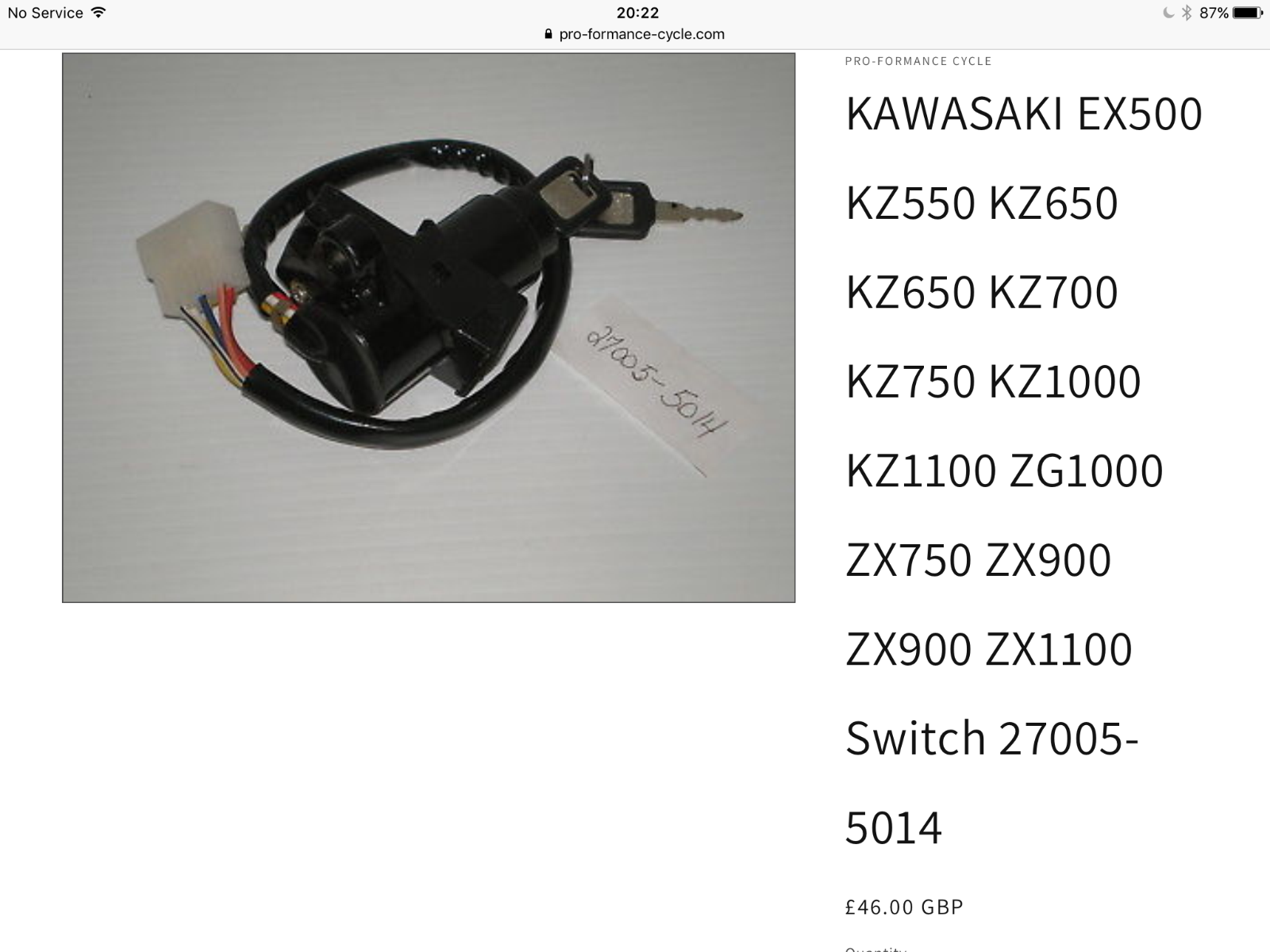

27 Oct 2023 14:47No, the part number you need is 27005-5014 (according to CMNSL) the one you posted is a different part number (later Kawasakis have a resistor in the switch as part of the anti-theft system)So, would I be right in saying that this is the same switch as those that you directed me to?

Z1Enterprises.com lists an Emgo 40-80610 ignition switch for the 82 KZ550-C3. There are a couple listed on EB UK.
