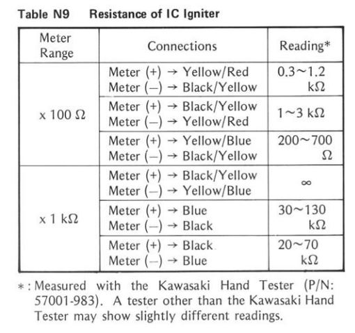

After installing and expecting it to fire right up, I got nothing but cranking with no kicking over. I checked for spark and I got nada. Whip out the old servicer manual to verify I didn't F it up, and confirmed it's all installed properly. Grab my DMM to check the resistance of the Igniter and it's open resistance across all terminals. GREAT!
I just bought a used on on eBay, it arrived today and out of the box I tried to verify the resistance, and the same thing. Seller wrote "ran when parked, no guarantees." so I'm asking if they'll accept a return. What are we (the community) doing about no longer available parts? I did read a blip about using a GM HEI module and building my own CDI, but meh. I might have to buy a point?

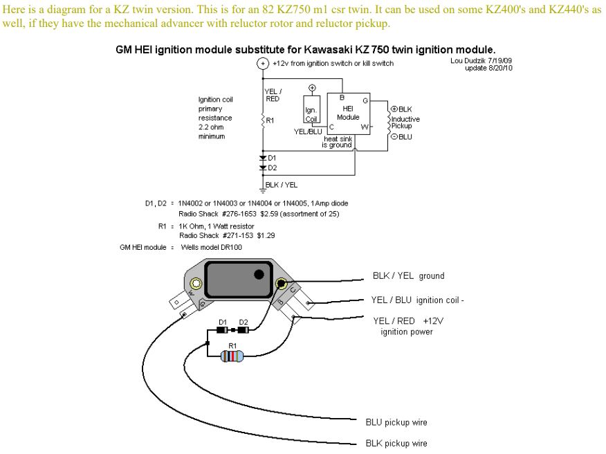

Re: KZ440 Ignition (Igniter)
20 Oct 2023 07:44
Thanks for your consideration Nerdy. I just received my GM HEI module in the mail, and still waiting to receive the 1 watt resistors. A soon as I gather all I need, I'm doing the Dudzik trick. If that doesn't work, I guess it's old school points
