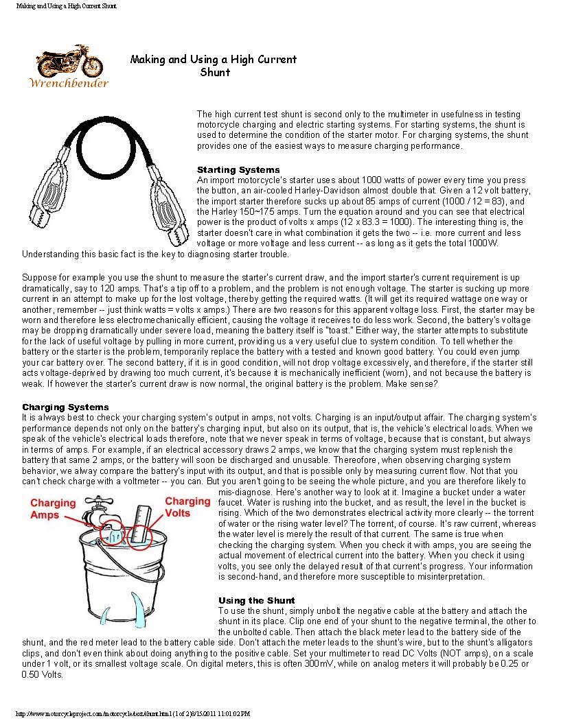

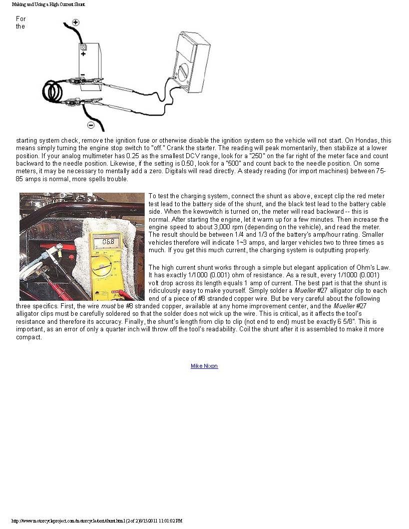

Here is some info on making and using a high current shunt to test starter and charging system. It come from Mike Nixon at welcometothemotorcycleproject.
