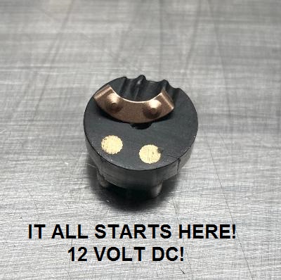

Hello, Marty in Buffalo here. I happened across this picture in my old files. And of course over all the years, hearing and reading about electrical issues, low voltage readings, the Wired George Coil direct wiring etc.
This is just my common sense opinion.
After so many guys spent countless hours searching, cleaning, scratching their heads? And so on! Still getting low voltage at the coils, ign. etc.
That yellow / red wire starts it path from the battery box area and goes to the handle bar kill switch!
2 - 1/8" circles of brass & a .012" piece of copper! Transfer that 12V's to the rest of the system.
Truthfully?? How many guys have dismantled this switch in detail to clean it like this?
My common sense way of thinking, but then again? What do do I know? "That and 50 cents will get you a cup of coffee" WE used to say that at work for 32 years! (vending machine coffee)
Just thought I'd pass this along! If it helps one motorcycle out? Cool.

Thanks for the post, Marty. We'd like to elaborate:
Much has been written about low voltage at coil primaries. In addition to the kill switch contacts, the ignition switch is a common culprit.
Some years ago, we assembled a basket case. Wishing to keep the OEM ignition switch & numbered keys led us to disassemble the ignition switch while chasing voltage drop & intermittent opens across it. Our findings are documented at the link below:
www.kzrider.com/forum/4-electrical/60681...-and-troubleshooting
