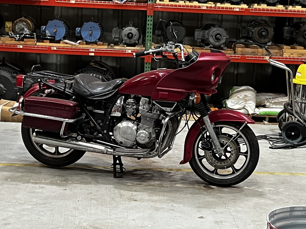

1984 KZ1000P,I have been re-grounding each component, trying to isolate the gremlin that turns on and off at will each light on the motorcycle. The lights work one minute and the next time that I turn the ignition key, they don’t. Its maddening. I have spent hours and hours trying to find the offending connection. Has anyone had this issue, and what was the answer?

It’s a retired police unit, so there’s wires everywhere. Neutral and oil stay on most of the time, all other marker, signal and driving lights alternate. I pulled the ignition switch, cleaned the contact points, greased the turn mechanism, soldered a wire back into place, put a new body and earth ground on. Presto, no improvement.
