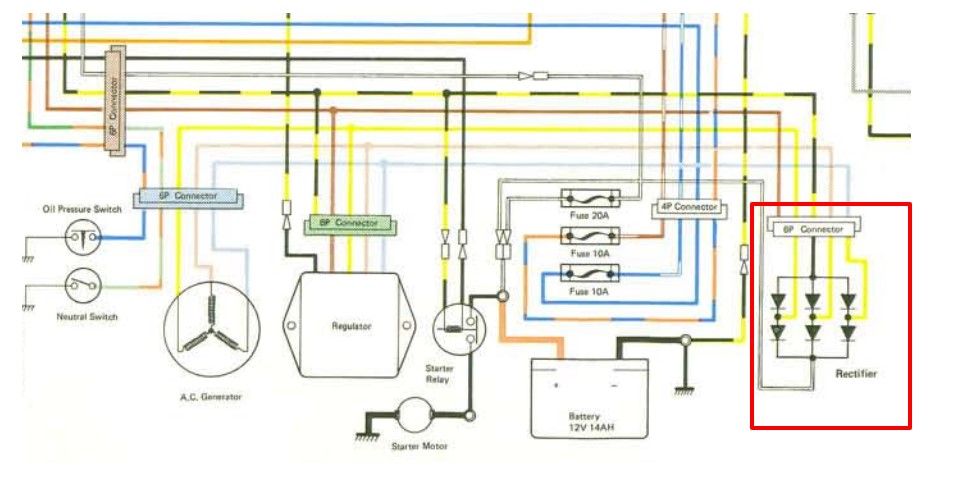

i would agree that it looks like it's had a regulator/rectifier conversion (can you post a picture of your R/R?) if that is the case then I don't know why they didn't simply remove the rectifier rather than leave it in there with chopped wires (which would be unnecessary, it could be unplugged and removed!!) I would suggest you start by comparing what you have to the below

17 Aug 2023 04:39 - 17 Aug 2023 04:45I have used an early KZ1000 diagram as the picture posted appears to show the stand alone rectifier (top right corner)Z1 and KZ900 have different wiring harnesses and mount points. A KZ900 wiring diagram is necessary to get it right. Some things are common between them but I think 76 was the year they switched from the old regulator and separate rectifier mounted under the battery box to a regulator/rectifier mounted under the left sidecover.
