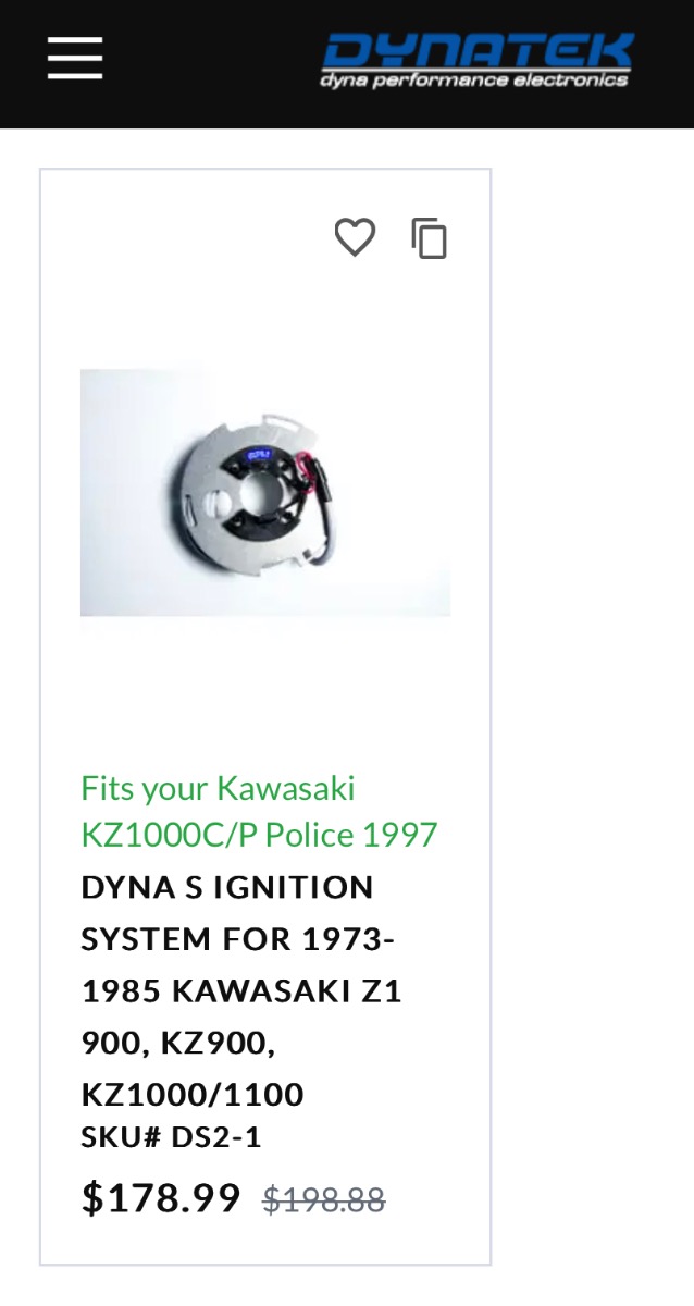

Hey guys, I have a 97 kz1000p that I’m wanting to get ignition for. On dyna’s website it says the DS2-1 will fit but it also shows only for years up to 1985. Just wondering if this is the ignition I need? Also how are the $50 knock offs on eBay? Can I use stock coils? Thanks!

Thanks for the reply! I have just under 3 ohms on my stock coils. It’s just weird that on the Dyna website when I search for parts for my specific bike, it shows that the DS2-1 will fit but under actual description it shows it fits up to 1985 kz1000. I had to strip all wiring because it was all crusty, unsafe and almost useless. I’m basically trying to get this thing going for the least amount of money and this would save me some wiring. I figured if the Dyna DS2-1 fits then I would just get the cheap knock off. Thanks again
