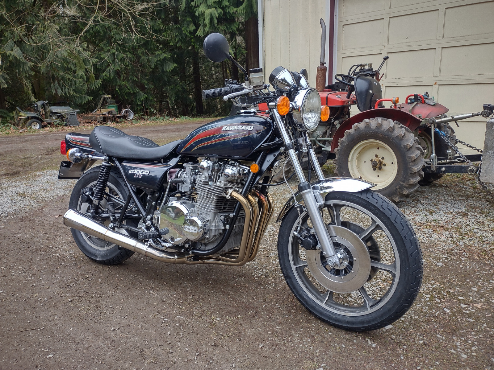

On my 77' KZ 1000LTD I installed a 7" Stanley H4 motorcycle lense from an early 80's Honda CB 750. You can get them fairly cheap on fleabay.
