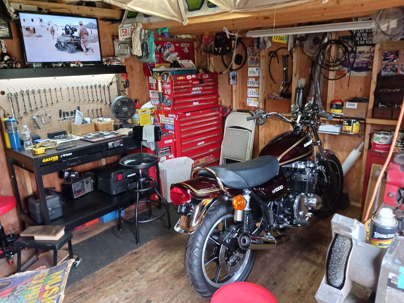

1978 KZ1000B w/ 73 body set and rear tail-light
1978 KZ 1000B (73 tribute)
