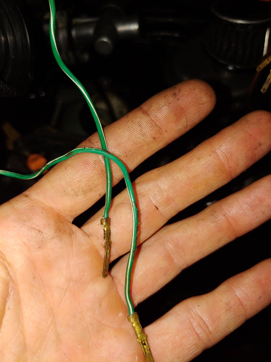

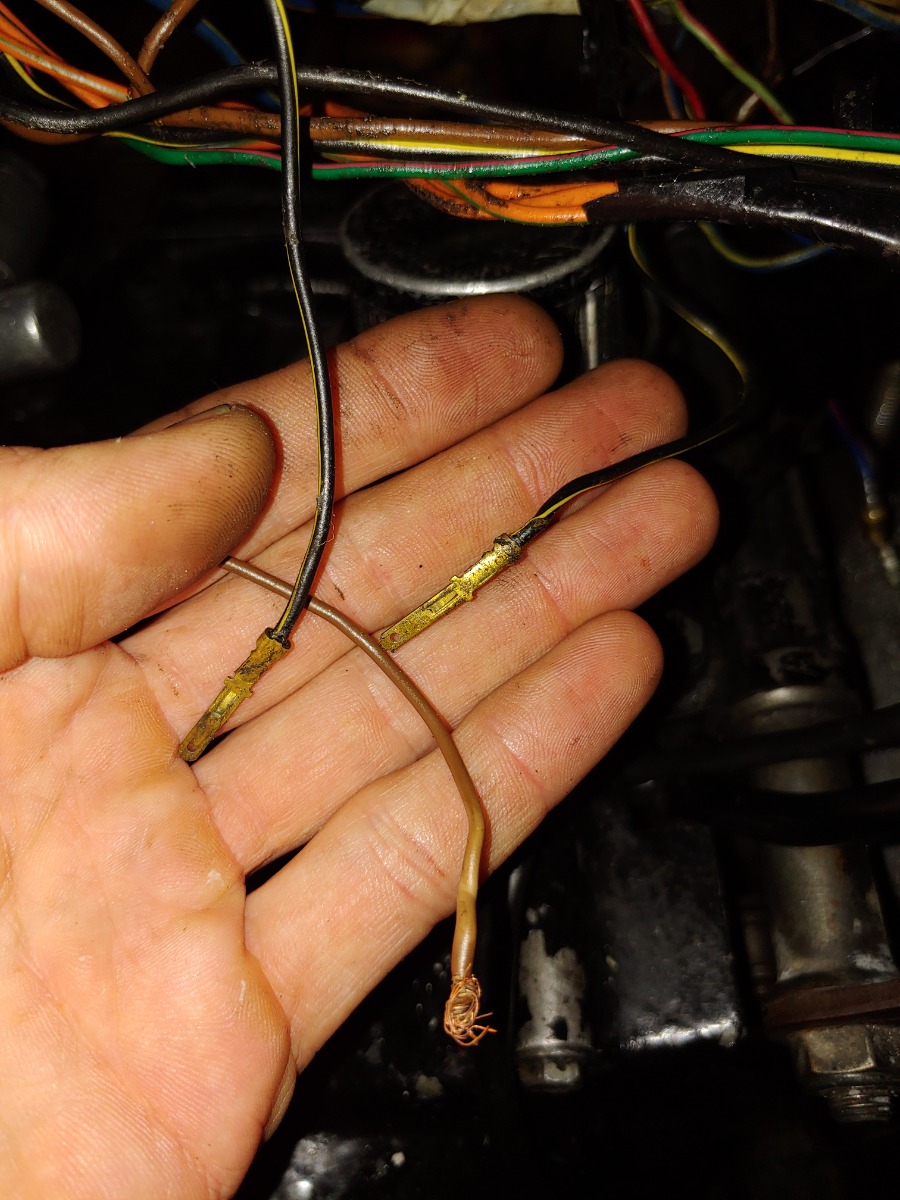

I have a 1982 kz750e2 4cyl and i dont have a fuel level sensor or kick stand switch so i have a brown wire, 2 green/white wires and 2 black/ yellow wires that i dont know what to do with. I can have a brand new battery or a fully charged battery and after turning it over once the battery with be drained. Is it because of these 5 wires that arent going to anything thats making it drain that fast? I have a downloaded manual but i get so lost looking at the wiring diagram. What do i do with them?

As long as those connectors and that raw wire on the brown cable do not touch anything metallic, they cannot drain the battery. On the other hand, if one of them accidentally brushes against something metal, it could cause a spark leading to a fire.
At the very least, those connectors and that raw wire need to be insulated with shrink tubing or some high quality electrical tape.
If you are not going to use the fuel level indicator, then I would chase each green wire back to the next connector, and remove it completely.
The brown wire may be more complicated. I do not have a wiring diagram handy for that model, but i suspect it needs to be reconnected to the wire on the other side of the side stand switch to complete the circuit. I recommend doing nothing with it until you are sure about how to proceed. Hopefully one of the members with electrical expertise will be along shortly with some sage advice.

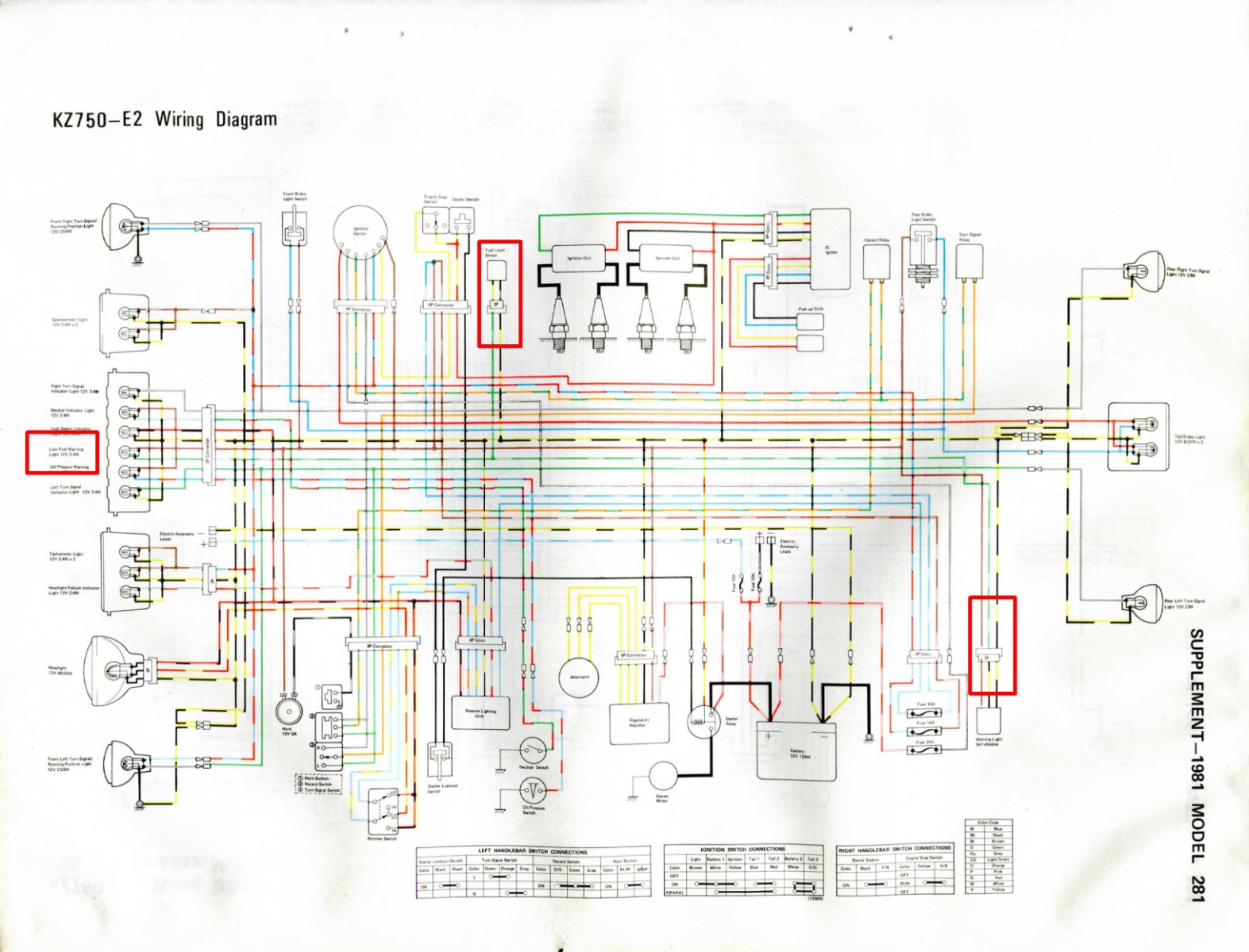

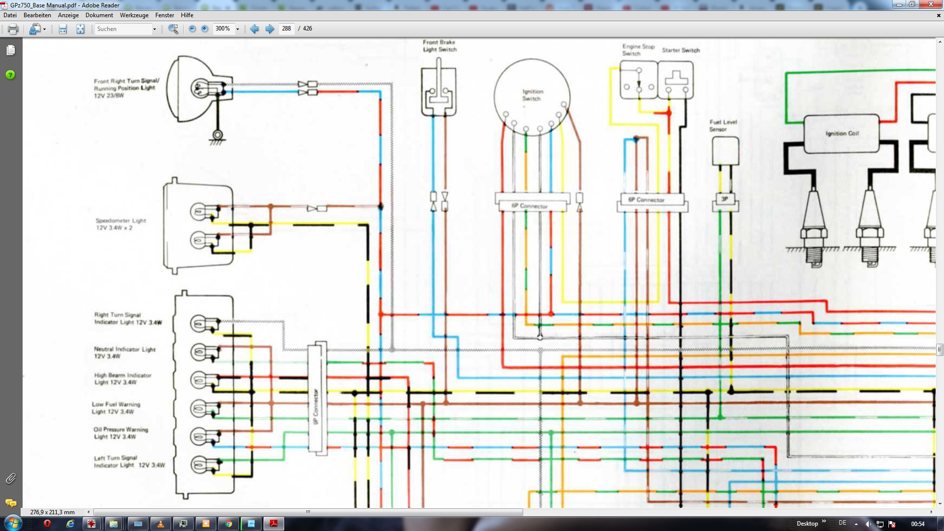

I think the brown wire is a hot one. If you have a meter you can check them all out but I'm guessing only the brown one is hot. Kawasaki often has a spare brown wire near the headlight for accessories.
The black and yellow wires are ground.It should not matter if they touch the frame, but they should be insulated anyway.
I'm not sure what the green wires are for. Sidestand or clutch lockout maybe?
The connectors on the wires indicate they came from a plug connector. If you look for plug connectors on your wiring diagram you may be able to find where each wire came from originally. The diagram should show wire colours.

I would secure the wires by installing plastic connectors and missing terminal pins, matching the oem stuff that's now gone. An open barrel crimper is handy for stuff like this. CycleTerminal, VintageConnections, or Z1Enterprises will have what you'd need. I would also label them for future reference. For any wires not routed to a connector originally, I would install good stock type terminal covers in which case you'd need to install new matching terminal pins. Additionally, you could secure any dangling wires w stock wire bands.
