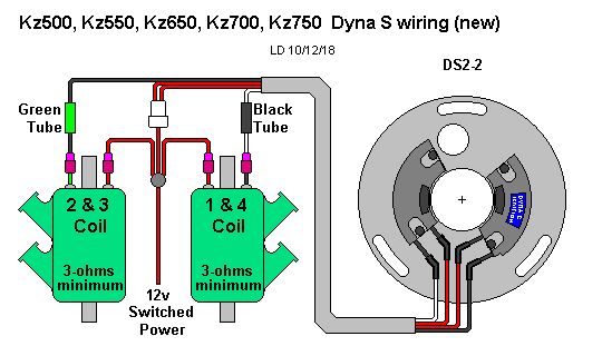

Before making any changes verify that the circuit is correct.  when the rotor is not aligned to fire you should get 12v on both coil posts.
