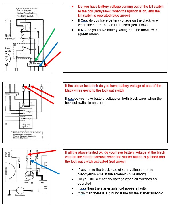

Howdy y'all. This weekend I started to install all the lights and other electrical components on my 750. When I turn the key to ON, the headlight, tail light, and idiot (warning lights) all turn on. When I try to hit to starter button, nothing. I've chased the wires and the only place I DO NOT have power is the starter button/right controls. Mine is equipped with a starter lockout switch and its good. I've even bypassed it with a jumper, still nothing. What am I missing? Is my starter relay bad? The right controls? Any help would be greatly appreciated.

Thanks Wookie.
So I do not have voltage at the Red/Yellow wire but 12v at the brown. Also, no voltage at the lock out switch.

22 May 2023 11:48OK take a piece of wire (ideally with a 10amp fuse in it) and with everything still connected bridge the brown to the red/yellow at the plug for the handlebar switch. If everything now works as it should including the lock-out switch then your "kill switch" is badThanks Wookie.

Woohoo! Kill switch is bad!!! Had to try it a few times because I wasn't getting a good connection with the jumper. Thanks for the help.
