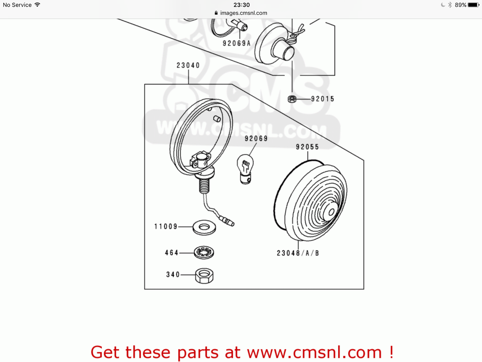

Thanks for the replies guys. I'm not seeing any screws on either the front or the back of the light.

I wondered about that, but the front lens and housing appear the same.

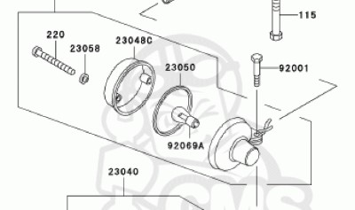

17 May 2023 01:29The front appear to have 2x screws (#220)I wondered about that, but the front lens and housing appear the same.

If you look closely, you'll see two small places on either side of the chrome housing to carefully pry off the lens.
