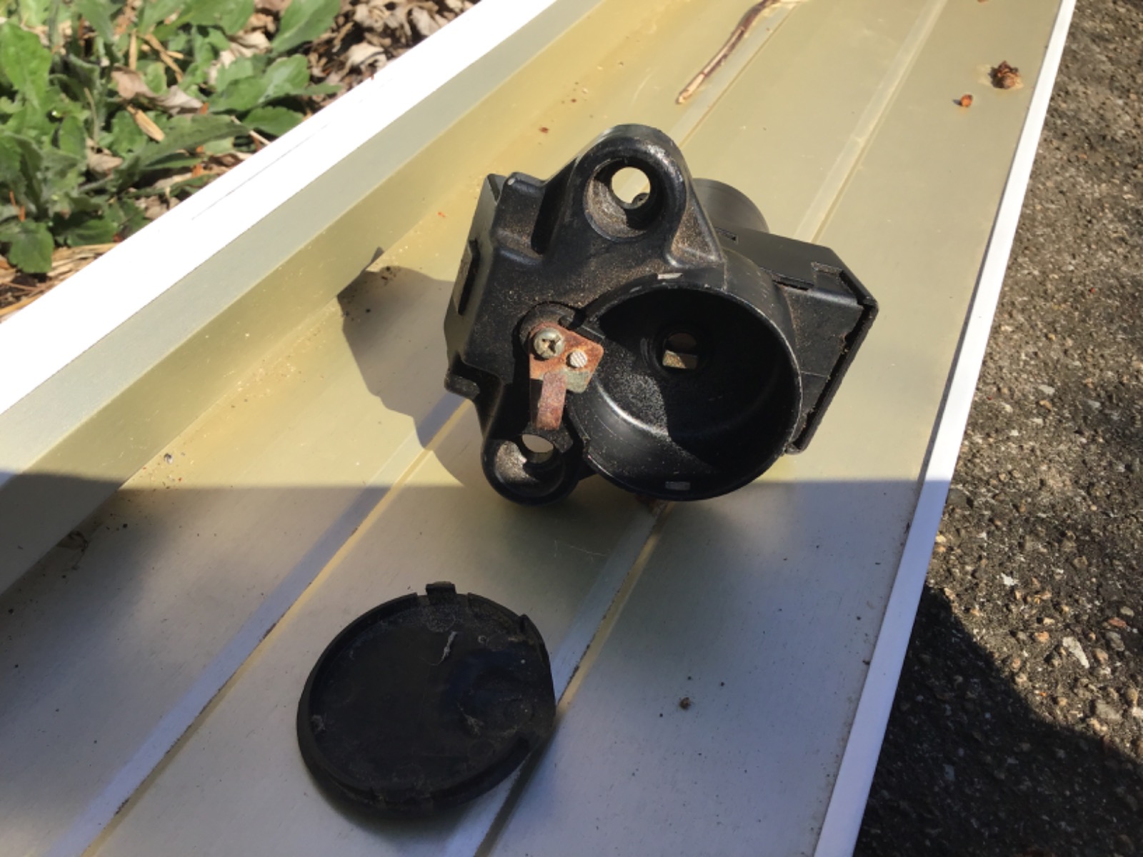

Hi, I have a 1985 Kawasaki GPZ 750 Turbo. The previous owner had three different keys (one for ignition, one for the helmet/seat locks, and one for the gas tank). I am missing one of the helmet locks and for bragging rights, I'd like to have an original GPZ key. I currently have a mix of hardware store specials.
I was browsing fleabay and saw this listing tinyurl.com/nhcf4ns2
The GPZ Turbo harness coming out of the current switch has six plugs and the one linked has five. Is it possible to swap my current harness from the tubro to the linked barrel and assembly? I get different part numbers for all the items, but the remaining locks in the link look identical. The only difference I can find between the two is the plug coming out of the harness. Was thinking it is more economical to swap them then to go through picking up a new helmet lock, key, and rekeying the existing lock.

Yes should work .heres a pic of the ignition with back open . Should be able to put turbo harness in new ignition no problems.
