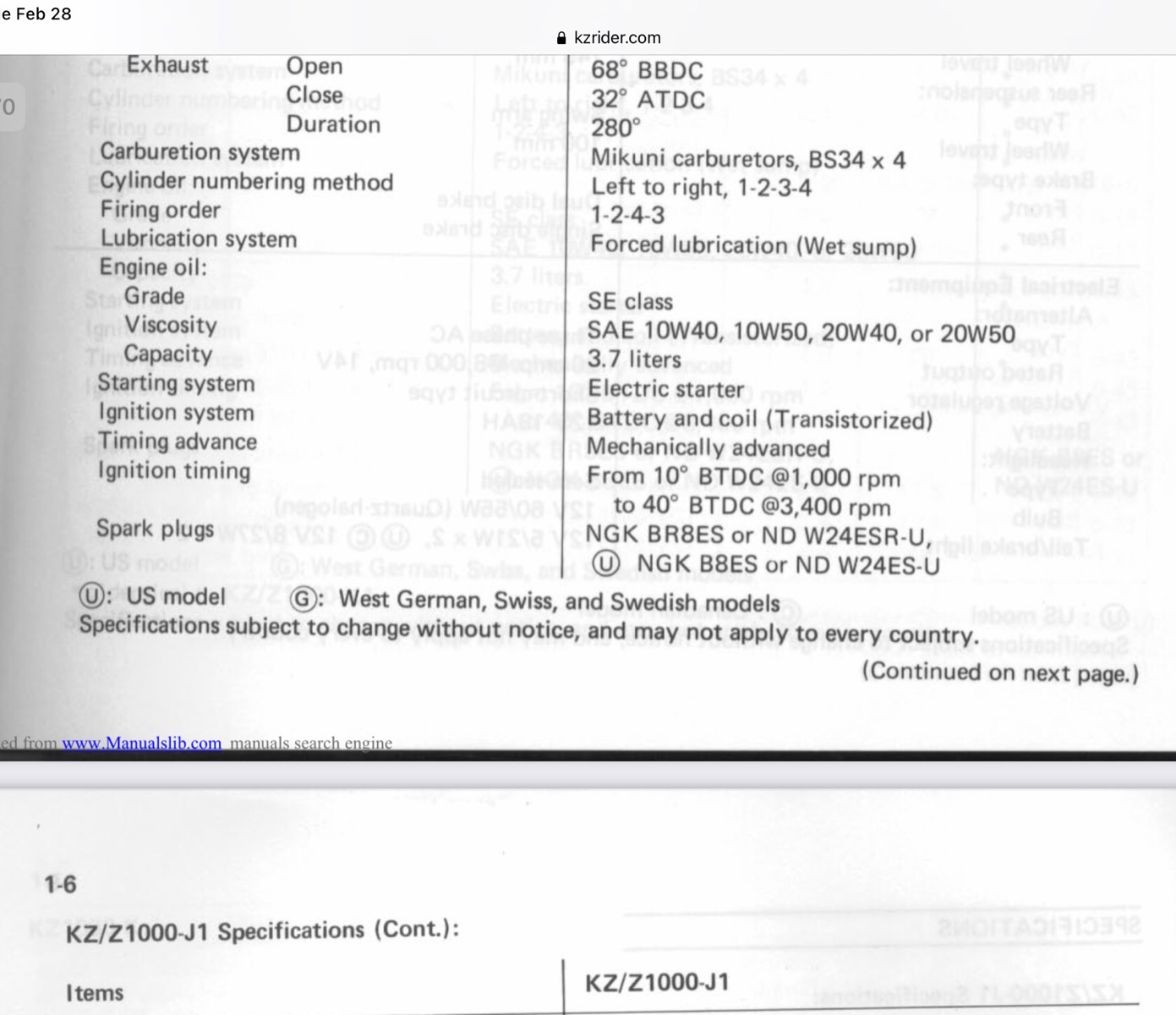

Re: NO SPARK THROUGH PLUG CAP
28 Feb 2023 17:58
NGK BR8ES Just like the FSM recommends. I don't get it
28 Feb 2023 18:02
So you recommend getting the B8ES Plugs instead of the BR8ES currently installed ? This bike ran last year before I rebuilt the head. I'm so confused lol. I appreciate the repy
