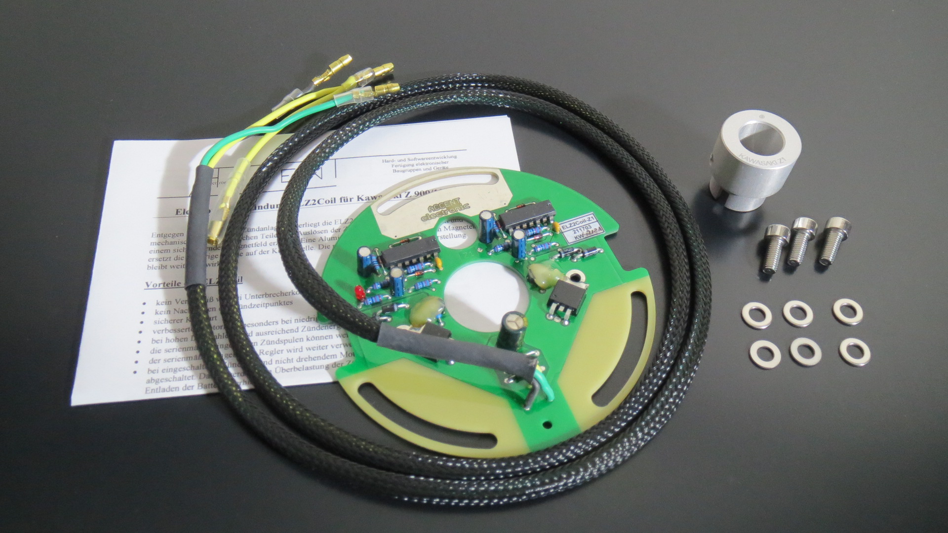

- Thanks: 2263
Re: Dyna upgrade z1a
21 Feb 2023 13:30 - 21 Feb 2023 13:33
z-fever.de/shop/en/product_info.php?info...nic-z1-900-1000.html
z-fever.de/shop/en/product_info.php?info...1006--advancer-.html
If the ignition is on and motor is not rotating the ignition coils are switched off.
This overloading the ignition coils and accidental discharge of the battery can be prevented.
No Blackbox original appearance is maintained.
Adjustable without strobo light.
Last edit: 21 Feb 2023 13:33 by Scirocco.
