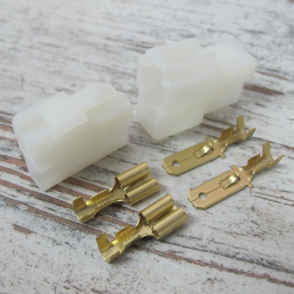

I would try to re-crimp for a tighter fit. Or you could install a new double bullet terminal. CycleTerminal or VintageConnections. maybe Z1Enterprises. Tinned terminals are probably preferable. My neutral switch was glitchy, so I cleaned up the connection & re-crimped. Silicone spray is handy for cleaning the wire insulation & for sliding the terminal cover up the wire.
www.cycleterminal.com/bullet-terminals.html

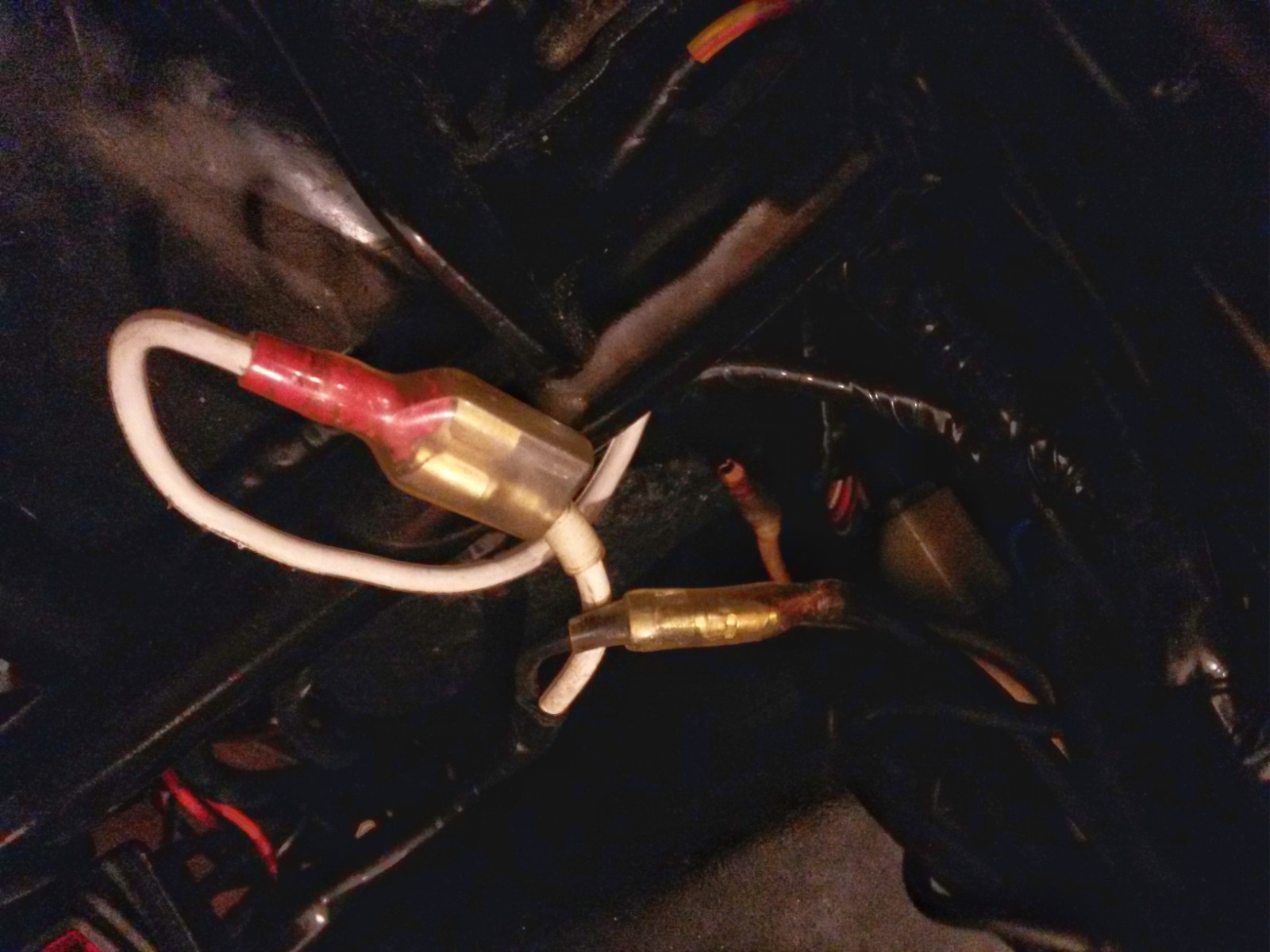

Squeezing bullet sockets is what I have been doing, but from time to time, as soon as I move a little, the cables slip out of their place again.
For some reason, simple bullet connectors (1 to 1) work much better.
Maybe I have to look for better quality double bullet connectors.
