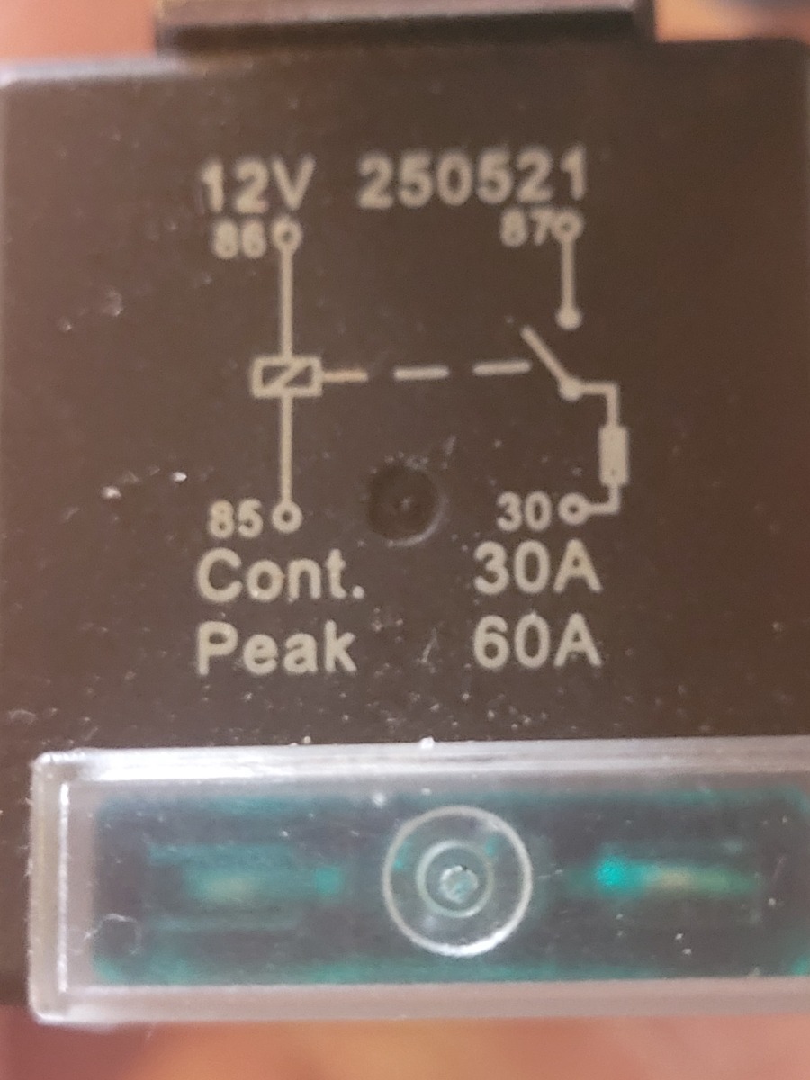

I have checked today again to make sure and the battery drains without the ignition On. If the kill switch is in the run position battery drains. In off position it is fine. i purchased a 30 amp relay from amazon and have wired it with as follows.(1) 2 red wires from dyna s to 87(2) 2 wires piggy back off 87 to the two orange live on the coils(3) one wire from the yellow/red double plug where coils attached before to 86(4) one wire from battery negative to 85(5) one wire from battery positive to 30

20 Jan 2023 07:51OK Deon, the relay wiring sounds correct so connect a voltmeter (red lead to red/yellow coil feed and black lead to battery neg) what does it read with ign off and kill switch in the "off" and then the "on" position - should be 0v in both positions. Anything more would suggest a possible ign switch fault but let's take it step by step - Carry out measurements with everything connectedI have checked today again to make sure and the battery drains without the ignition On. If the kill switch is in the run position battery drains. In off position it is fine. i purchased a 30 amp relay from amazon and have wired it with as follows.(1) 2 red wires from dyna s to 87(2) 2 wires piggy back off 87 to the two orange live on the coils(3) one wire from the yellow/red double plug where coils attached before to 86(4) one wire from battery negative to 85(5) one wire from battery positive to 30 [

Your problem is almost definitely stemming from the ignition if you have full battery voltage with the ignition "off" then either the ign switch is faulty, it has been by-passed or the wire between the ign and kill switch is shorted to battery positive

Just an update, hopefully someone has some ideas. The ignition is not very good so decided to get new one to eliminate the switch. When i unplugged the old ignition i found, on the harness side, someone has joined (very badly) the yellow going to stop / run switch and the white going to 20amp fuse together. I separated these 2 wires which has stopped the battery drain. But now i dont have any working lights on the dash at all. It also looks as if someone has had the ignition back off at some stage. I had to return the new ignition to z power as it was not the right switch and Phil does not know if he will be able to get one. So at the moment its not going very well. The bike is the US important kz650E1 and seems a problem to get parts for. Does anyone know where or what else to try.
