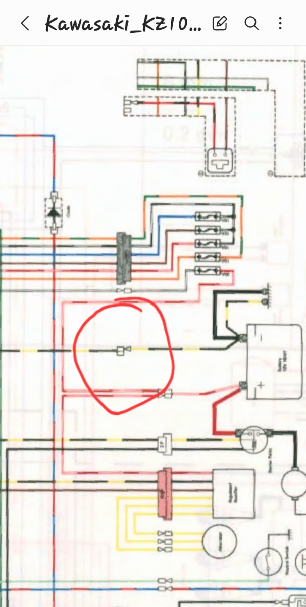

Kinda sounds like the loom is not earthed back to the neg terminal.
On the neg battery pole there are normally two wires. One is the big thick one that earth's the engine. The second is a normal loom sized wire. This second wire normally has a bullet connector which connects to an opposing wire from the loom. Both are normally either black or black and yellow. If these are not connected cleanly bulbs like neutral and oil will still work as they earth through the engine via the thick wire to the battery neg. Pretty much nothing else will work as it won't be earthed.
Not sure on you bike where that connection will be but it'll be close to the battery, possibly under the rh side panel.
Both male and female connectors will be single bullet not part of a multi connector block.
May just need pulling apart and cleaning or may not be connected at all due to when you changed the battery you inadvertently dislodged the connection from moving the neg terminal wires.

So I checked, cleaned and made sure the ground was true. Verified that the fuse block is bad. First fuse from the left side has no voltage. So I am looking for an OEM fuse block.
Thanks for all the help
